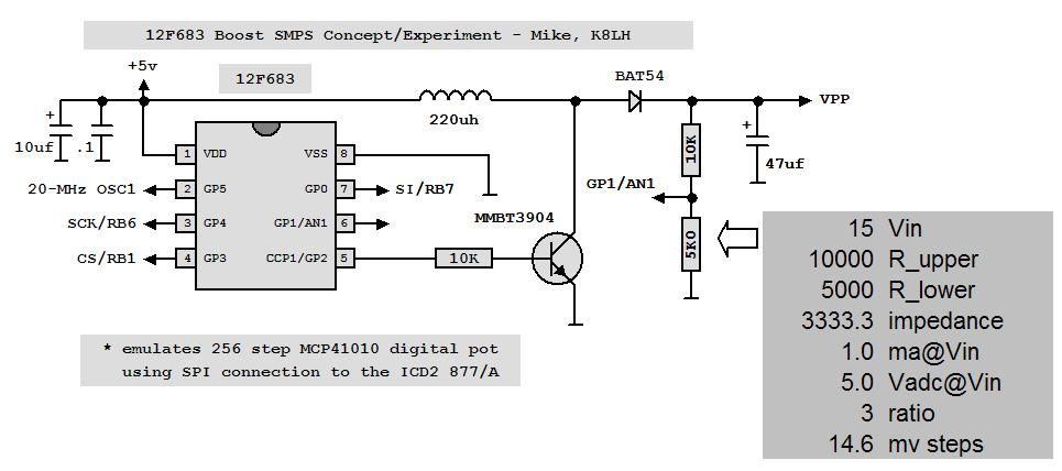

Gentlemen,
Would you double check my logic please? I'd like to perform ADC conversions at 20-usec intervals (50-KHz) within an ISR using TMR2 interrupts.
;  ADC PWM processing (PWM pulse skipping algorithm)
ISR_ADC
        bcf     PIR1,TMR2IF     ; clear TMR2 interrupt flag       |B0
        movlw   DutyCyc         ; normal duty cycle value         |B0
        movwf   CCPR1L          ; assume VADC < VSET              |B0
        movf    VSET,W          ; voltage set point               |B0
        subwf   ADRESH,W        ; ADC result hi                   |B0
        skpnc                   ; VADC < VSET                     |B0
        clrf    CCPR1L          ; VADC > VSET, skip pulse         |B0
        bsf     ADCON0,GO_DONE  ; start next ADC conversion       |B0
        retfie                  ;                                 |B0
I'm assuming that after setting the GO_DONE bit in the ISR that a conversion will take place and that the next ADC acquistion period will be fullfilled by the time the next 20-usec interrupt occurs.
Will this work?
TIA. Regards, Mike

Now I have had time to figure out what you are trying to do, I think your logic is fine. I'm not as sure about your timings. TAD (conversion time per bit) has a minimum of 1.6uS (typically 2.0) and it takes 11 per conversion = 17.6uS + 2*TAD after conversion. The sample and hold capacitor is disconnected during conversion and when reconnected requires around 19uS acquisition time.
So, I think your scheme will work but at about half your current speed.
BTW, is this some sort of SMPS design. If so, I would be very interested in your results.
P.S. I'm assuming 16 series.

Hi Mike,
The code is for a 12F683 boost SMPS.
Thank you for the timing info'. I'm going to breadboard the circuit and start experimenting.
Mike

Mike,
Have you considered using the comparator with Vref. It would only give you 16 (maybe 32) possible voltages but would be a lot faster. You would then also have the distinction of being the only person I have heard of to use the comparators.
Mike,
I did think about the comparator with internal Vref, but as you mentioned, it doesn't offer very much resolution.
I don't really know where the experiments will lead. It's just something I'd like to become more familiar with.
Take care. Regards, Mike
