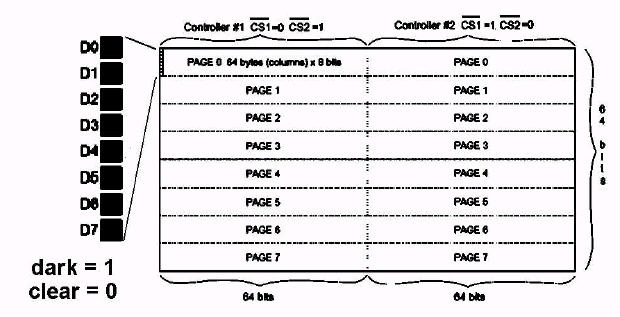

hi guys
i am having some problems getting a graphics lcd display k0108 to interface with a pic 16f887
maye someone can help me here
i am using asembler language as this i am an old timer and dont understand c as well as i dont have any compilers for c so asembly language it is.
here are my problems
1) i seem to be able to reset the display and switch it on when i do this part of the routine i get all the pixels on this is not to much of a problem as i can send a couple of commands to clear the screen so i can turn on the pixels that i want. but according to all the datasheets i have been able to get hld of on the internet if you do a reset then the display should return to position 0. i would think that it should aslo clear the screen.
this is not happening what appears to be happening is that the glcd has some type of memory in it so when a reset is done it goes back to the place it already is at and does not clear the display.
2) also there seems to be a problem with the adresses as if i point to position 1 page 0 z=0 then the display goes to seven pixels across, so if i put in a y adress of 58 then it starts at the beginging of the line.
3) also if i try to write to cs1 and cs2 together then the lcd does not respond
to any changes after the first write i gather therefore you have to access the one then the other.
please could someone look at my code and then let me know where i am going wrong if at all

On the GLCD I owned, there is no RESET command one can send to the GLCD. When powered up, the GLCD enters a RESET state and user can check if the reset operation has finished via reading the STATUS byte and testing a bit in it.
The reset operation will not clear what was displayed on the LCD. In fact, on mine the previous data still remains even if I remove the main power for a few seconds and power it up again. Therefore user must be pro-active to clear the display by writing to every pixel to switch it off. This can be easily done via a loop.
With regard to the pixel addressing, you need to check the datasheet. I offer an image to help you along in understanding the addressing scheme.
You simply cannot write to both GLCD Controllers at the same time, similar to one cannot write to two memory locations at once.
I just looked at the **broken link removed**and reset only sets Z=0 not X & Y and doesn't clear the display.
One other thing, in the above data sheet it does not mention the fact that to read data from the display, you have to do a dummy read first.
