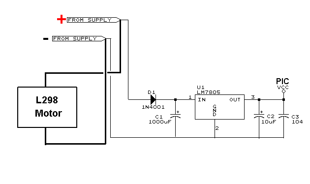

As always run the power ground separately from the logic ground. Connect them at a single point on the L298.

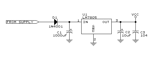

You don't have to run separate power supplies. You can use a common supply with the equivalent capacity of the two supplies put together. However, you can protect the logic from the voltage dips by adding a rectifier diode ahead of the filter caps. This will hold steady the voltage input to the regulator for the logic even if the supply to the motor dips.
Motion,
A clever solution. One problem with your approach is that depending on the current draw of the logic it may take a very long time to discharge the filter capacitor when the power is removed. This may not be a big deal unless you need to cycle power to recover from runaway firmware. I think waiting more than a few seconds would get kind of irritating after several repetitions. Just my opinion.

Do not let the voltage drop along the supply cable due to motor current affects the PIC supply.
The following arrangement will help if you have a good(+12V gel battery or regulated) power supply.

Awesome! Thanks everyone for the FAST replies! There's definately a passion for electronics in this forum! I'll give the one supply circuit a try. I'm amazed at the number of diodes out there that have specific functions. Just out of curiosity, why a 1n4001 for this circuit? Looking at the spec sheet, it seems like just a basic diode, nothing fancy.
the dude of dudes said:
... why a 1n4001 for this circuit? Looking at the spec sheet, it seems like just a basic diode, nothing fancy.
that is correct. it's purpose is to prevent the surges from pulling down the filter cap.
Note that if the voltage in is close to the voltage out, you might want to use a schottky diode to reduces it's forward drop so as to give the regulator a bit more head-room. silicon is around .7V and the schottky will probably less than half that.
