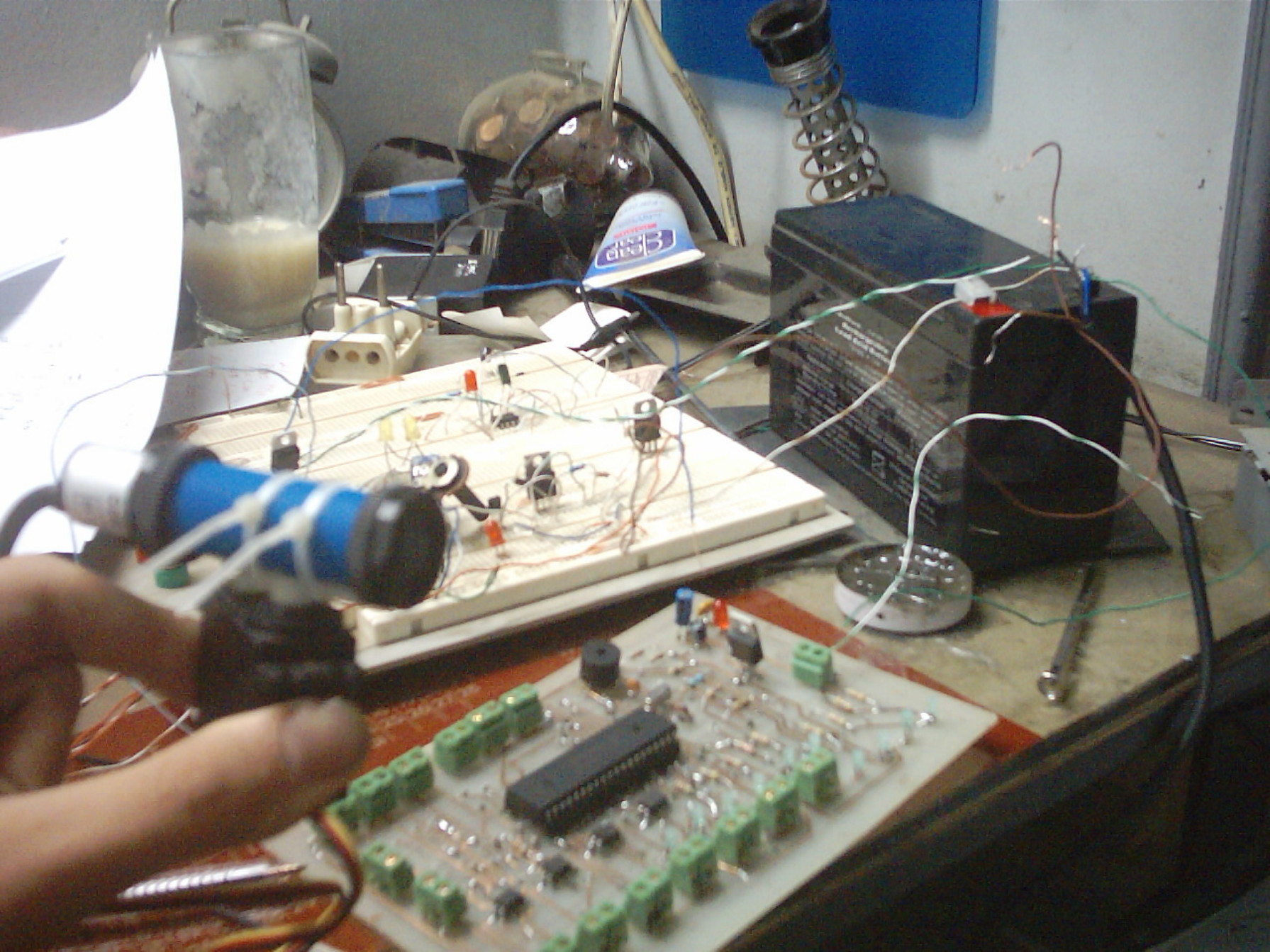

i tried my rader using servo motor and a photosensor.
it works well ,
my program go like that
////for i = 0 to 100
servo pin,pos1
delayms 13
next i
///if sensor = 1 then goto LED, to turn on a led for 2 seconds
and i repeated this part for 10 times and each time i'm changeing the value of the position untill i reach the final destination , after each step i scan the sensor as you notice in the if statment
waiting for your comments.
