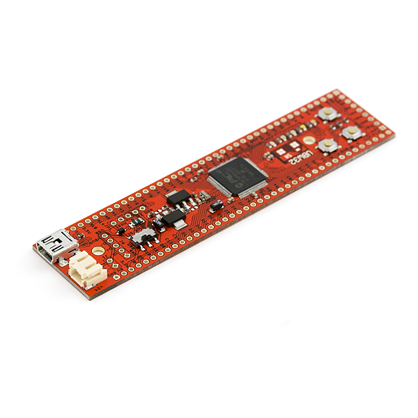

I have read data sheets howto's tutorials but what I was looking for was right on my computer It's in the Mpasm assembler Help file. And I don't want to for get Nigel's even after what chips I first got he didn't use any of them. But that's OK I now have all of them. and learn a lot to boot. If
I could only find a brake out board for a pic 32 I could start learning it to . Thanks for all the help
