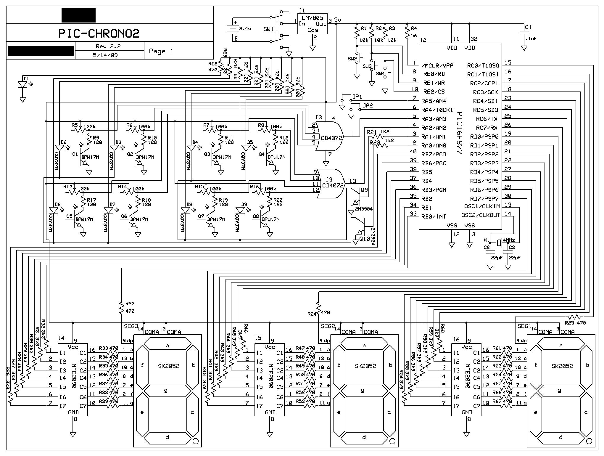

Alright, so here is my problem.
I've been working on this chronograph which uses a photogate system to measure the speed of an object that flies through the two gates.
I've gotten most of the final program for that taken care of. However, because it is the first of it's type I made a very short program which would allow testing of all of the various inputs and outputs.
I know that there are many problems already, but I just figure that I would go down the list.
all three of the 7-segment display's and their drivers are working properly
here's the problem I'm trying to figure out right now...I can't get any of the inputs to function properly, specifically any of PORTE. the circuitry with the three switches does what it is supose to do, leading me to believe that it is a programming issue.
Attached is the circuit diagram and the current program
If anyone does notice a problem with the circuitry please tell me as I still can make minor changes, but I already have a PCB made. (the circuit is currently on a breadboard for testing)
Any ideas on what the problem could be?

do you switch off the A/D?
i think 16f877 has A/D on PORTA.

Though there is a problem with the two inputs on PORTA, I don't think that it is the PIC in that case. I'm trying to at least get the inputs on PORTE to function before I move on to the main optocouplers.
Also, the first design had the three segments run off of one pin on a smaller PIC, but that would only allow the display of numbers.
EDIT----just looked at the datasheet. all of the A/D control bits are automatically set to be disabled during start up if you leave them alone

The PORTE pins become the I/O control inputs for the
microprocessor port when bit PSPMODE (TRISE<4>) is
set. In this mode, the user must make certain that the
TRISE<2:0> bits are set, and that the pins are configured
as digital inputs. Also ensure that ADCON1 is configured
for digital I/O. In this mode, the input buffers are TTL.
you don't have porta or porte set to digital i looked at your code
At power up all analogue capable pins are set to analogue and will not function as digital inputs. You need to write 0x06 to ADCON1 to make them all digital.
It also works better if you set your (tris) first then (clrf) the port

thankyouguys for the help, I'm inserting the segment of code
MOVLW B'00000110'
MOVWF ADCON1
into the "INIT" label (in the proper bank) as well as clearing the ports after the tris have been set for each port.
one quick question though,
Will setting the ADCON1 register affect RA1 and RA0 as they are being used as outputs?
nope you want it all digital that it dos it turns off adc so you can use the porta as output or input pins

Note that ADCON1 is in bank 1.
and.......IT WORKED!!!!
thankyou again guys for all of your help
it all worked as it should, except for one of the gates, but I'm pretty sure it's just a short or this ancient 4072 has a problem. (made in 1986, and the casing looks kinda iffy)
if it is something else I put up another question in this thread.
Hah, there wasn't a short nor was there a problem with the OR gates. I forgot to set all of the 100ohm trimpots to about halfway. There was one on the assumed failing gate that didn't have enough resistance to keep the OR gate from tripping
