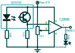

I wanted to build a car to follow a line, and for that, I use the component CNY70 ..
my doubt is whether the links that I use for the PIC ..
Hi, if you mean how do you connect it to the PIC, then follow the diagram below.
In the blue box is the CNY70. You will also need the 220R current limiting resistor for the LED and the 10K pull-down resistor from the transistor.
Where it connects to pin 3 of the op-amp is where you want to connect it to your PIC.

With just one CNY70 the robot won't be able to follow a line.
Using a black line (to follow) the right and left sides must be white (IR sensitivity) to recognize crossing the black line and correct path as necessary.
