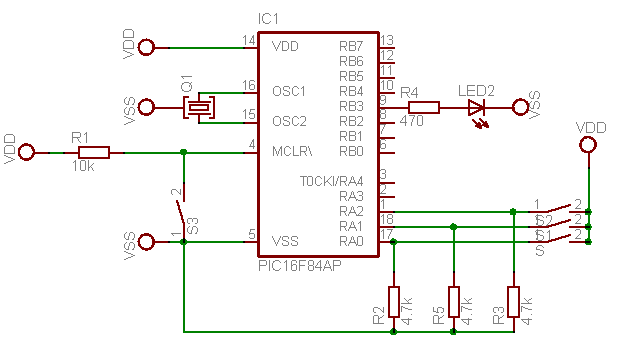

Hi, im working on a time fountain and im starting to write the pic code, i just started learning assembler through some tutorials.
i tried to write a program that when RA1 is high then led on rb3 goes high,
i connected the circuit like in the picture and wrote this program.
i know forsure that all connection are good since i burnt the pic with a led blinking file and it worked. as for the switches i soldered them well and they should work but i haven't seen them work yet.
list p=16F84
radix hex
STATUS equ 03h
TRISA equ 85h
TRISB equ 86h
PORTA equ 05h
PORTB equ 06h
bsf STATUS,5 ;Switch to Bank 1
movlw b'11111'
movwf TRISA ;Set the Port A pins to input
movlw b'00000000'
movwf TRISB
bcf STATUS,5 ;Switch to Bank 0
Start BTFSS PORTA,1
goto LedOff
movlw b'11111111' ;Turn the LED ON
movwf PORTB
goto Start
LedOff movlw b'00000000' ;Turn the LED OFF
movwf PORTB
goto Start
end
can any1 help?

if your using a switch you probably need to debounce it there a lot of ways to do it search the forum its a sure thing that it had been discussed before,
the way i do it is pass the signal from the switch through a buffer that usually works.
good luck

hi agian,
ok so i have no idea what wrong i cant write anything that works.
im using mplab, and everything compiles well but not even the simplest program works. when i burn the pic with not-made-by-me files it works. but nothing i compile works.
here is exactly what im compiling why dosnt it set 7 port b pins high

You need to set the config file. See **broken link removed** for an explanation.
Basically you need a line such as,
	__config   _XT_OSC & _WDT_OFF & _PWRTE _ON & _CP_OFF
for it to work.
This also means that you need to include the definition file.
	include	"p16f84a.inc"
