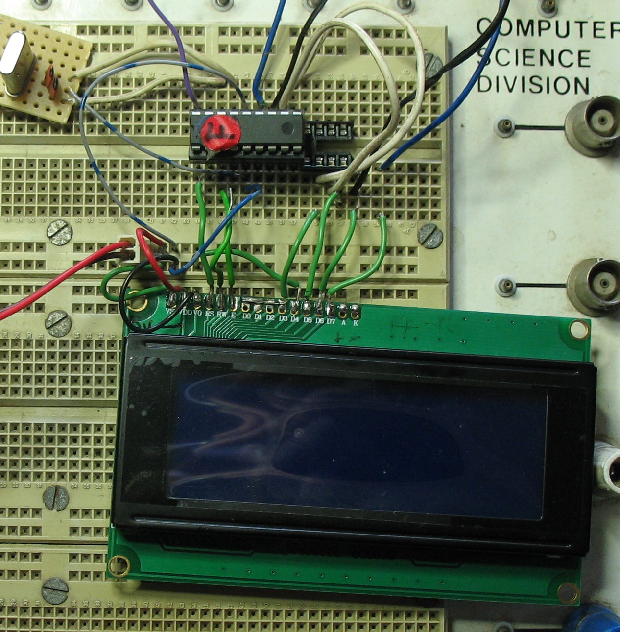

So, works in the simulator, and not on actual hardware...is that correct?
And what is your "actual hardware"?
Got a schematic you care to share with the rest of the world?
Maybe a few pictures to go along with it?

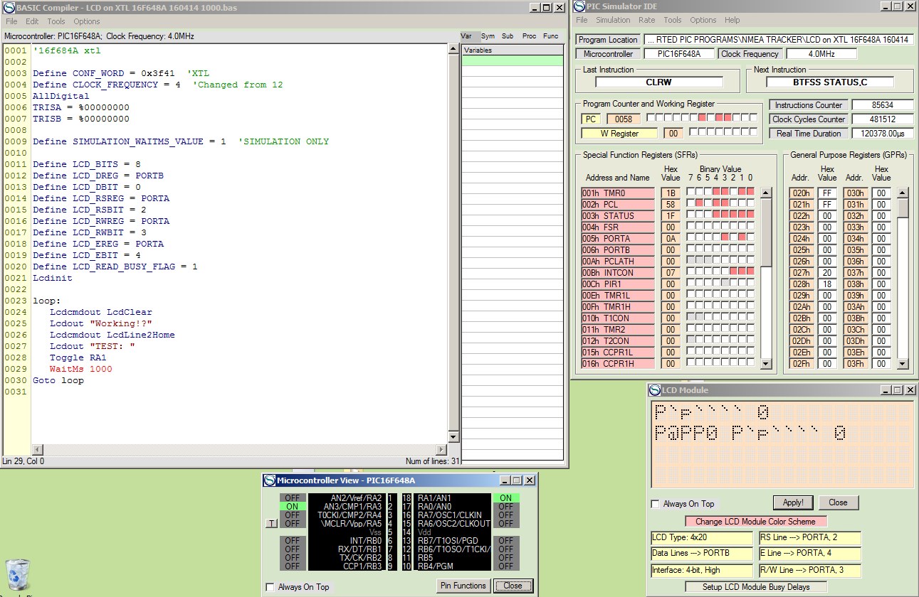

Yes, I have swapped it round a few times, and #11 should be the last.
Post your schematic.
Post the code in the message.
Is the Ra1 pin output as default?
I added the TRIS's to make them all output.
The image shows incorrect readout in the SIM, but I tried again and it is OK.

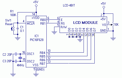

I looked up schematics similar to the one I posted, I used R/W, but I've tried swapping the pins and ports around quite a bit as tests. Are there any wiring configurations that should not be used? Iadded a XTL after trying with out.
Maybe you go back thru and re-do your wiring and your program completely.
First look at the wiring for the circuit shows me 5 immediate problems for sure, and another 4 possible problems.
First look at the code shows me another 4 problems that don't match up to the circuit with 9 possible problems.

I'm rewiring it, but from those immediate wiring problems you can see, can you give me any clues, so I don't simply repeat my mistakes? I hope you are looking at the program I posted in #16? Noting that the schematic posted is only a guide, as I have changed it since.
