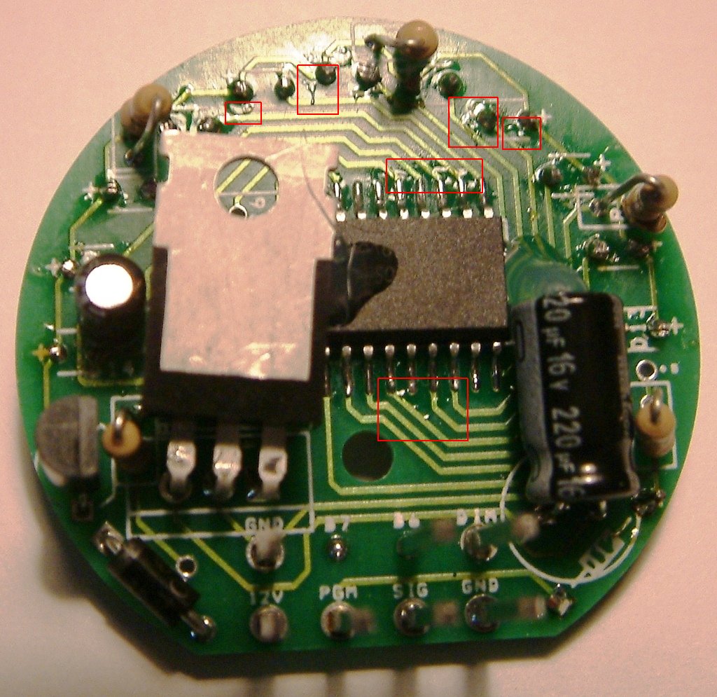

I have a circuit that drives leds from a reference signal, the circuit does not function correctly and the company that supplied it are not now available. I have opened the unit to establish what is used in the circuit, and has somebody told me in a previous posting it is using a 16F88 ic. Now my question is - first is there anyway that i can read the program file from the ic while it is soldered on to the pcb (it is a surface mount ic) secondly i wish to have a go at pic programming / development myself and would like some suggestions on the best development / programming equipment needed. I have looked only on ebay under pic development and there are plenty of kits available from china at reasonable prices can someone give me some suggestions on what to buy, i will be a novice to all this at first but should pick it up pretty quickly (hopefully) as i already program a lot in basic and have a broad knowledge of electronics so something that will be ok for starters but also suitable for more advanced use later would be better i think. Wish to get started as quickly as possible so all suggestions will be looked into

If you can describe the function of the circuit a little more then we may get a better idea of what might be possible. A picture of the board (both sides) would also be useful.

photos of pcb
Hope this works !!
The first thing I would do is clean off all those solder splashes also check the joints and the copper links that have been added.
The assembly is messy.

I think if there is any kind of critical timing involved here, I would be removing that regulator as it's dropping ~7v or more all over the top of that there PIC and directly heating it. Now that really can't be a good thing...
Either find a better one, or at least move it out of harms way.
Clean up the board properly, as stated earlier, it's a mess.
Check all your joints are sound and short free.
Check your power supply is correct pre and post regulator, I'm assuming it's a 5v reg, so you should see at least 4.95v on it's output, if not investigate why.
If that proves fruitless, check that the oscillator is running, those pesky little cylindrical crystals can be a pain sometimes.
Check any reset circuitry is correctly operating and that the PIC is not being held in the reset state.
if all appears as it should, check other things like capacitors fitted properly, especially the polarity concious ones, check resistors for open or high resistance, track continuity etc.

Hi, thanks for all your suggestions. I will check the board sometime today and post the results. As far as what happens at the moment when i try to set up the unit, firstly when trying to set the centre point of the indicator (midships) i cannot get the centre led (yellow) to come on if the potentiometer is moved to the centre position, it will only set if the pot is left at one end. The red leds (port) are flashing dimly and the green leds (starboard) are all on or all off when the pot is moved. The correct function with the red and green leds should be that they illuminate one after the other as the pot is moved from the centre position to one side or the other.

The symptoms suggest a loose connection somewhere on the board. I'd try cleaning and re-soldering any suspicious looking joints.

The general consensus is the pcb's need reworking, check the joints, solder bridges, wiring joints.
Have you done a quick check on the pot, either resistive or measuring the wiper output voltage.?

EDIT: check the RED boxed areas.

I did do some tests when i first opened the unit on the regulator voltage etc and checked the pot which seemed ok but will now go through the board in more detail under a glass so i can see everything better.
