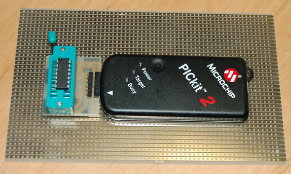

Fred,
here is a pic of a ZIF board I made for my PicKit2... :D
I've made a couple of different versions, to cater for different VDD / VSS locations on the various PIC chips I use.
Currently working on making a 40pin universal (jumpered) version..

Cheers for the layout Mike.. :D
I know what I'll be doing this week.. laying out a PCB to hold the 2 ZIF sockets!

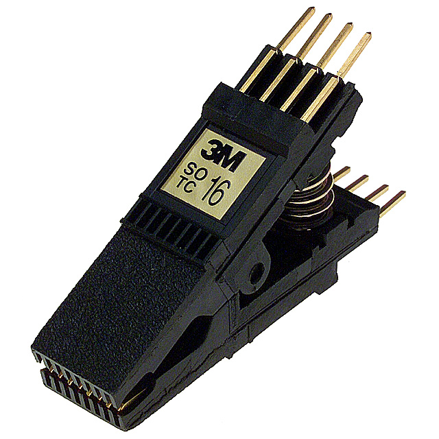

I think I'll look into getting a 20 pin ZIF to program the DIPs and some various SOIC clips for SOIC programming. I'll deal with SSOPs when the time comes. I'm not sure I could even solder them in place.

Fred,
That looks almost exactly like what I want to make for the DIPs. Would you be willing to share that board layout? If not, no problem.
