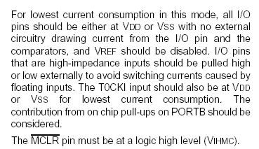

You can probably figure this out by checking the DC characteristics (datasheet) of your PIC. It lists typical current drawn by peripherals used (example from 16F628A datasheet attached). There is quite a difference between VDD at 3 and 5 volts, not to mention between F and LF devices!...
There's also a small paragraph with tips on how to draw minimum current before sending your PIC to sleep, see attached.

Electrix said:
1. How much current does a PIC draw when in sleep mode ??
It depends on many things.
First of all you should put all unused pins as outputs, inputs should be pulled high or low. In short - No pins should be left 'floating'.
Switching currents in floating pins will increase power consumtion by a lot (upto mA's !).
The Brown out circuitry also uses quite a lot of current, if you want the absolute minimum you'll have to decide what you want. No Brown out - and the posibility of the pic going nuts when it's supply voltage goes to low. Or with brown out - but even in sleep mode, power consumption will be enough to drain batteries in a couple of weeks.

There are features that will draw even more current than the BOR if left enabled. Check the datasheet!
