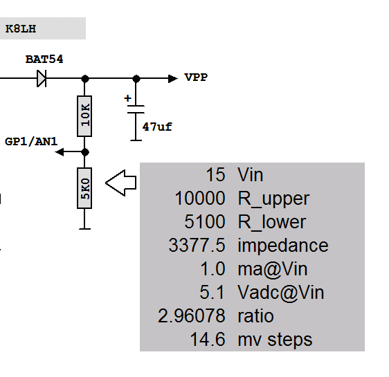

I use the following formula to determine the impedance at the center of a resistor divider (the ADC input);
impedance = 1/( (1/rUpper) + (1/rLower) )
So in the case of a 10 KOhm pot', the highest impedance occurs when the wiper is in the center position;
  rUpper  rLower  Impedance  Position
   5000    5000   2500 Ohms  Center
      1   10000      1 Ohm   Full CCW
  10000       1      1 Ohm   Full CW
Here's a screenshot of my spreadsheet where I use that formula (I input Vin, R_upper, and R_lower values and the other values are caculated from those);
adc-calc-png.31097
Kind regards, Mike, K8LH

Sorry Eric, I forgot the picture yesterday, I still ask my question.
adc-calc-png.31097
Hi Mike, I see your formula and the spread sheet, i think you made a typo on the ratio part, which should be 10000/5100=1.96078
Like i asked Eric, why you have connected a capacitor? For filtering?
Thanks both of you.

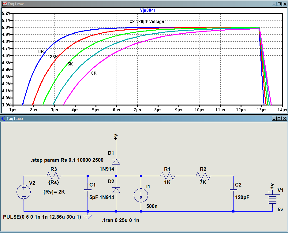

hi MikeK8.:)
The divider rule for the 10K pot is not the full story, ie: central rotatation =2K5
This may be the 'impedance' seen by the PICs adc input pin, but its not the time constant of the pot and PIC's internal 120pF cap.
Consider that the 10k pot is set to its 0V position and then is quickly changed to 2.5V [50% rot], the charge path for the 120pF is 5K to +5V.
Likewise if the pot is set to +5V [100% rot] and quickly changed to 2.5V, the discharge path for the 120pF is 5K to 0V.
The external 1n0 has been added to provide the 'charge' source/sink for the 120pF.
As Pommie points out this could be allowed for in the acquisition time within the program.
Also when using a 10K pot the manual change in the pots setting/voltage output is slow compared to the PIC.
The 2K5 impedance rule applies if the adc input is changing rapidly and accuracy is required in the conversion.

hi Syed,
Attempt to simulate the ADC circuit in LTspice.
Its rough, but it clearly shows the general idea.
