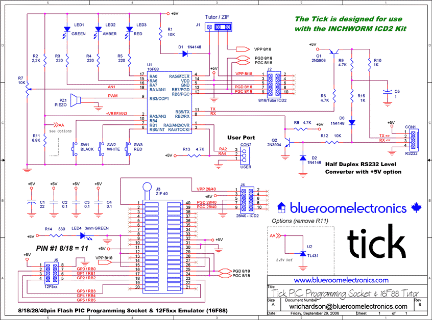

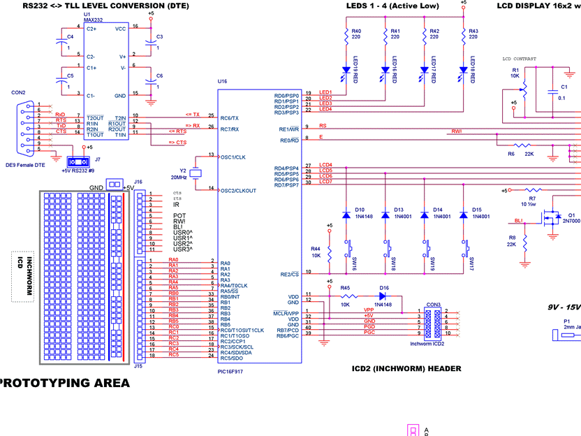

I just found it thanks. C is a language I've always wanted to learn. I'd like to put a book together with experiments for one of my next PCBs.
Not sure which to build first...
1. Tick (A ZIF socket programmer with a 16F88 tutor)
2. Dolphin (A 16F887 / 877A tutor with LCD, buttons, LEDs and a protoboard)
Tick about $40, Dolphin about $80
