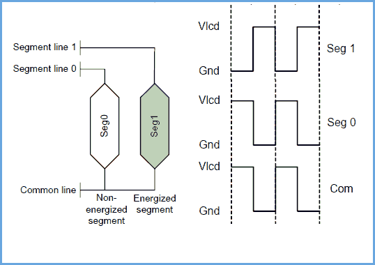

Futterama said:
So, what you are saying is that it should be driven by +/-3V compared to GND/common pin?
Perhaps an image would give you better idea. The common connection in this case is powered with a 0-3V square wave.
If the segment is powered with the square wave with similar phase, the voltage on the segment terminals change together and there is no net voltage across the segment. The segment will be OFF in this case.
If the segment drive square wave is opposite to that of the common line, the segment will experience +/- 3V across its terminals and turns ON.
When you view the drive voltage of a "ON" segment referring to ground, the voltage on two sides of the segment is like a "seesaw", while one goes up the other goes down.

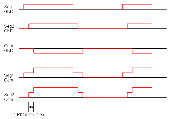

I have tried to make a signal drawing, take a look below.
Perhaps it needs some explanation.
The first 3 signals (Seg1-GND, Seg2-GND, Com-GND) is the signals on the PIC with respect to ground.
The last 2 signals (Seg1-Com, Seg2-Com) is the signals seen by the LCD segments.
The time from when the first segment is changing state to the Com is changing state, will be longer when more segments are added. If there is 30 segments, the time will be 30x500ns at best (8MHz PIC OSC).
Will this 15uS really have any effect on the LCD life?
By the way, this is my drawing without the make-Com-pin-input-before-changing-state idea.

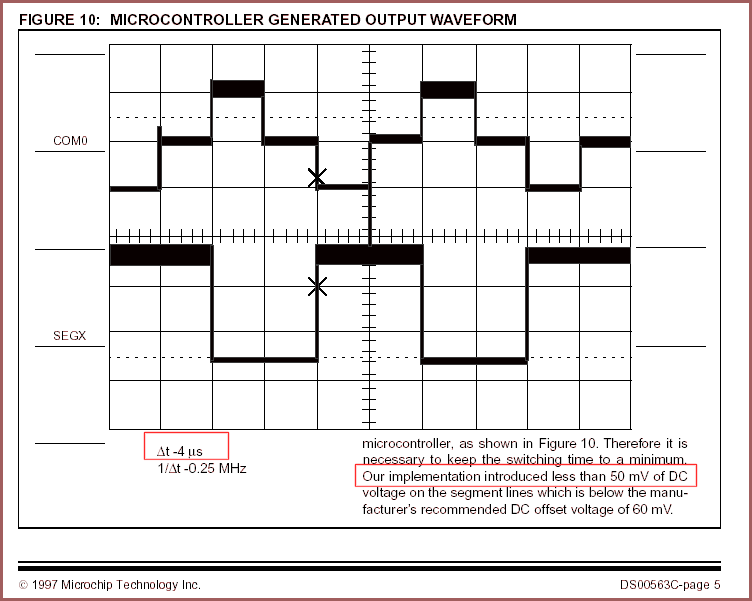

From the last page in original datasheet link you have posted.
A 4us delay resulted in some 50mV net voltage on segments and the manufacturer's specification is max 60mV. That's very close to the limit.
So your 15us delay would possibly result in a lot more net voltage?
That's correct, I missed that.

If it really is impossible to to this with direct drive from the PIC pins to the LCD pins, does anyone have an idea of a circuit that would help? I'd rather throw in more components than burning out my LCD in a week :roll:
Edit: Perhaps I should find a circuit that generates -3V, and then switch from +3V to -3V on the segments and leave the common pin at GND. I could use some transistors to switch the voltage or perhaps some IC supplied with -3V as Vss, and +3V as Vdd that outputs Vss to Vdd signals.
