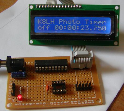

Hi guys,
I just hooked up a 44780 type LCD to a PIC for the first time a few days ago. No big deal, right? Well, I haven't worked with a 44780 type LCD in about 10 years (on a 68HC12 project) so it was pretty exciting for me when it came to life on the first try (grin). I'm sure all of you know that feeling.
Anyway, I was wondering if anyone was interested in my approach for the 44780 subsystem code (in assembler)? The subsystem is relatively small and includes a PutLCD macro with 'type' and 'data' parameters, an InitLCD subroutine to reset the LCD and place it in 4 bit interface mode, and a low level driver. I'm also using my little 12 word DelayCy() subsystem for LCD write delays because it's easy to setup for almost any clock frequency.
The PutLCD macro only supports five different 'type' parameters at the moment (more to come) but I'm very pleased with it's capabilities so far. The macro automatically sets the LCD 'RS' line before calling the low level driver and it also selects the appropriate LCD write time delay after a write operation (it knows to use a 1.53 msec delay after a Clear or Home command, for example). Here's an example to illustrate how I'm using the macro and subsystem;
What do you think?
Mike

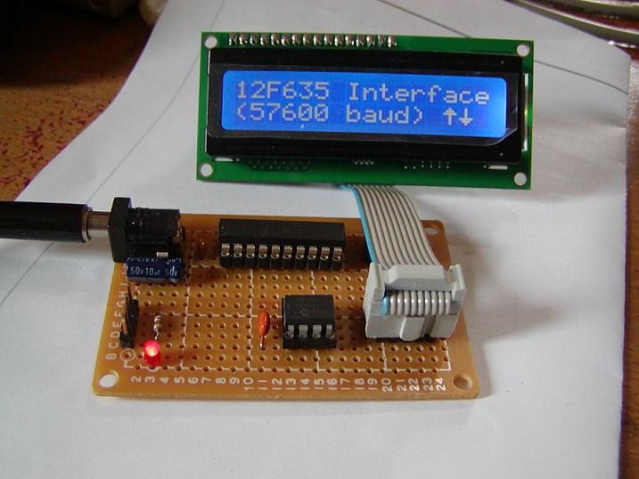

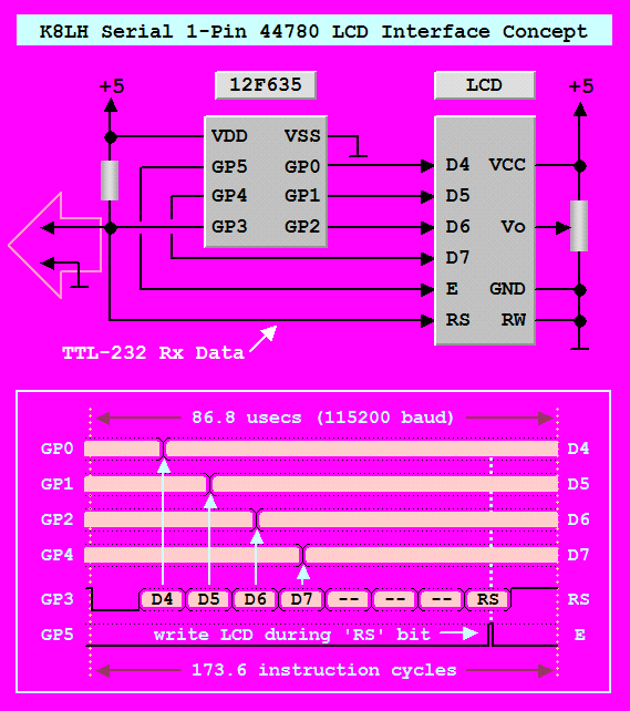

New development..... K8LH 12F635 Serial 1-Pin 44780 LCD Interface
Late tonight I got an 8 pin 12F635 device working as a Serial 1 Pin 44780 LCD Interface at 19200 baud. The host was a 16F690 device.
As far as I know, no one has used an 8 pin PIC with only 5 outputs to drive a 44780 type LCD which needs six signals, so I'm pretty geeked. Basically, I tied the serial Rx line to the PIC and to the 'RS' line on the LCD. The LCD ignores the signals on any of its control lines until it receives an 'E' strobe so I simply latch the D7..D4 data bits onto the PIC outputs as they arrive in the serial bit stream and I provide the 'E' pulse to the LCD during the middle of the 'RS' bit as it arrives in the serial bit stream. I should mention that I send each 8 bit data byte as two separate serial bytes so I use a custom low level driver on the 16F690 host device.
I've attached the 12F635 source file for those who may be interested and I'll follow up with an example host side low level driver in a couple days.
Have fun. Mike

My novelty 12F635 Serial LCD Interface is now working at 57600 baud.
It didn't come up on the first try but then I realized I had a 3.68% bit rate error when I setup the host 16F690 for 57600 baud using BRGH=1 and BRG16=0. There's also that 1% tolerance of the INTOSC to consider.
The interface did come right up however after switching to BRGH=1 and BRG16=1 on the 16F690. That configuration produces a much more tolerable 0.8% bit rate error.
Here's a picture of my LCD test board with 16F690 host driving the 12F635 interface at 57600 baud.
Mike
Updated drawing and host low-level driver;
k8lh-12f635-lcd-interface-png.43792
;  K8LH low level 44780 LCD driver (12F635 Serial LCD Interface)  *
