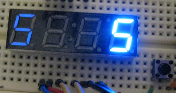

I've got a 4-digit 7-segment CA display hooked up to a 16F886. And I've got a problem with a ghost digit. Even though I've got the anode turned off it's drawing 0.9uA. Not much current, but still produces a ghost:
(That's a little brighter than actual, because of the high ISO camera setting.)
It's got me stymied. I've tried other unused PIC pins to drive the anode and get the same result. I'm pretty certain it's not the code but here it is (in JAL):

When I test the other blanked digits they're not drawing anything (0.00uA). And it's not the individual digit, because I can get the same result on another digit by swapping the connection. I also swapped in a red display and got the same results.
I'm don't know JAL, but it looks like you are updating the digit data before changing the digit select. So try turning off all digit select and adding a delay between digit changes:
    -- ones
    portb = d1
    porta = digit1
    _usec_delay(delay)
    [B]porta = 0[/B]
   [B]_usec_delay(50)[/B]  --You may get away with less

Doh! You nailed it. Thanks, buddy.
Didn't need the delay, just to shutoff all digits before setting the segments. Thanks for catching that.
