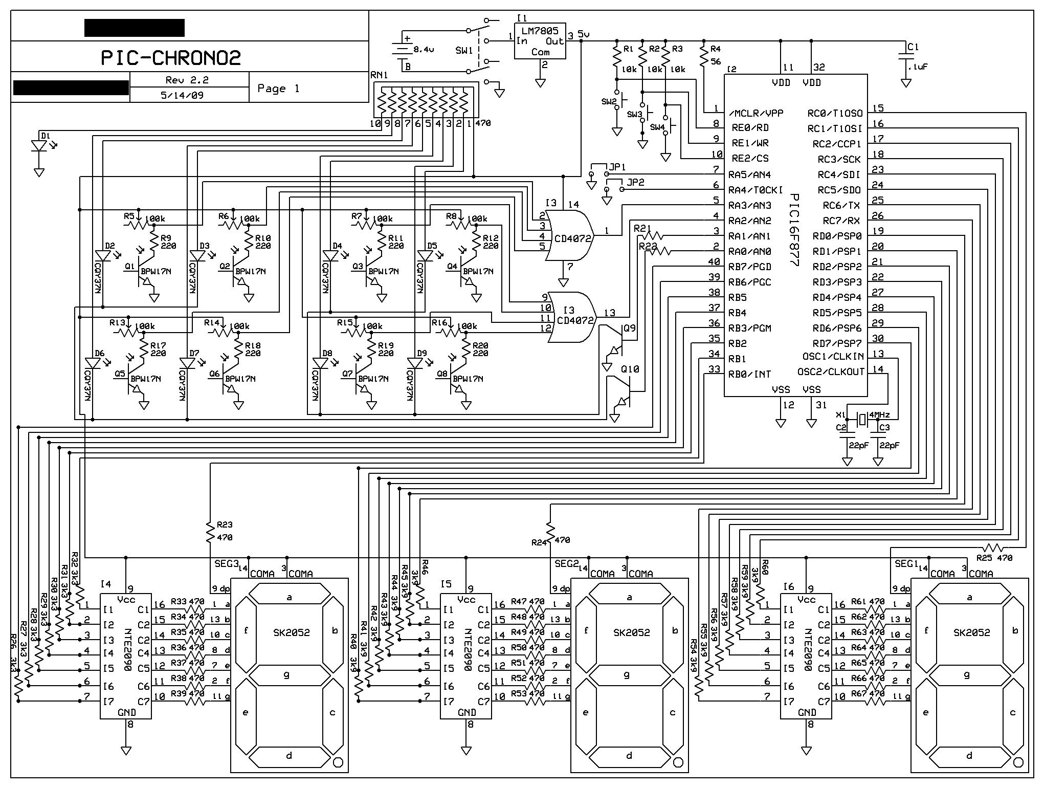

well, here's my problem.
I've been revising/reworking an old project (might recognize it as the PIC Chronograph from another post)
it is now built with a larger microcontroller, and has a more sensitive 2 gate system.
in the programming, after the first photogate has been broken, the microcontroller will begin increasing a counter/storing #'s in a set of 3 registers.
these three registers will store the # in a decimal format. the first register for the 1ns place, the second for the 10ns place and the third for the 100ns place. (meaning it can only store a number at or below 999)
when the second photogate is broken, the counter will stop increasing this #.
the # stored in these three registers will be the amount of time there is between the breaking of the two gates.
the distance between the two gates is 1ft. it has been set up like this to help make the programming a little bit easier.
I need to somehow divide 1 by that # stored in the three registers so that I can have the device display the speed of whatever broke the two gates, but I have no idea how to do that using the PIC's instruction set.
I am programming in PICassembly using MLAB IDE
any ideas?
attached is the circuit diagram
(sorry, the image was invalid on the first message, so here it is again)

An idea: convert the 3 digit registers into a 16-bit integer then use a prewritten division routine. You'll have to scale '1' (1 foot I assume) to, say, 1000 to give you feet/us or else you'll keep getting 0 as a result.
A division routine is available here: **broken link removed**

Last night, my partner for this project came up with an algorithm that will take care of what we need.
Say x represents the number stored in the register.
In the program we then have x added to itself a Q number of times until the result =y, or a number that is equal to/slightly greater than one. At the moment that x added Q # if times together is greater than one, your speed is given as Q.
It is only accurate in very high velocities and doesn't give decimal numbers (Q is a whole number) but we just make a second loop that goes into the tenth place or hundreth place. I'm not quite sure how to explain it here, but i've tried it through my partners explanationm and it works.
Thankyou guys for your help, but I can't modify the circuitry any more as I already have a PCB ready and waiting for the components to arrive in the mail.
If anyone else has any suggestions I'd be glad to take them, but unless there is something that will work much better than our algorithm posted here, the programming will use what my partner came up with.
Yep "inversion by addition" is how I would have done it. By simply choosing the correct value for Y (the destination) you scale the result, so you can use different values of Y to give a result in FPS or m/s etc.
Once you have the first decimal digit you get the remainder, multiply the remainder by 10 and just do it again to get the second decimal digit. Etc for more digits.
It's not that fast as a calculation but it is pretty "bulletproof" hehe get the pun? ;)

Ok, let's say the detectors are 1 foot apart, the bullet goes through and you get an elapsed time period of 253uS. To convert from a period to a speed (like feet per second) you add X to itself until you reach Y (which is 1 second or 1000000uS).
So;
Add X to Accumulator until it reaches 1000000;
(it is added 3952 times, reaches 999856)
the remainder = 144
so feet per second = 3952 and (144/253)
Now if you need the result in metres per second, you just use a different Y value, so instead of Y=1000000 you use a new Y=304878.
(feet/metres = 1/0.304878)
So use the same hardware, and same calc code but just with the new destination Y value;
Add X to Accumulator until it reaches 304878;
(it is added 1205 times, reaches 304865)
the remainder = 13
so metres per second = 1205 and (13/253)
Obviously the remainder can be processed with a similar "addition division" to the main calc.
I hope that answered your question? You see that the same hardware and excactly the same code can give the answer in FPS or M/S, and the code is very compact and brutally simple, just a loop and addition, although it is slow time-wise (which doesn't matter at all for this app).
