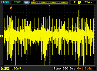

If you have a DSO use it on infinite persistence, look at PIC supply rail
to see what pk-pk noise is, if it stays within spec.

What noise looks like on infinite persistence on a supply rail or input -
Ultimately over time it will be a solid band of pk-pk noise. I see normally ~ 200 mV
typical, get worried if I see 400+mV. Check data sheet specs on power rail tolerance
and bypass recommendations.

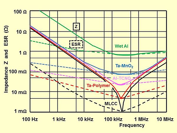

Capitor effectiveness for bypassing :
Normally a bulk and a ceramic on a processor supply pin.
