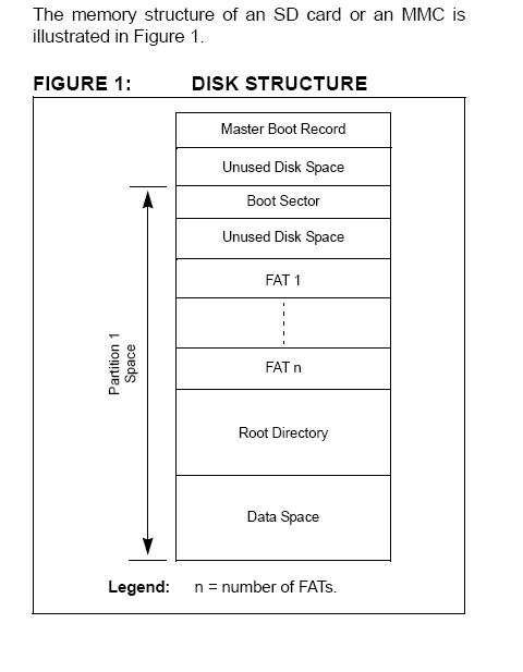

i'm working in a project in which I'm exploiting IC of s1mp3 mp3 player, this kinfd of mp3 players has a SoC (System On Chip) called ATJ2085 which manage a NAND flash memory (a SAMSUNG k9f2G08U0M, it's not SD or MMC) through parallel links and use the FAT16 as a file system for it. in this project I have to share this memory with the PIC (18F4525) to write, read and display with an LCD -connected to the PIC-the content of the flash memory (songs, texts,etc....), and here I get a big problem cause all application notes and C programms for PIC that I did found in internet were made for SD, MMC cards or CF (Compact Flash) who communicate with the memory for R/W through the SPI bus !!!!

Memory structure of MMC/SD card

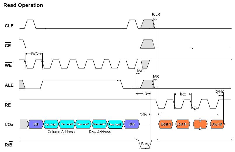

i'd like to know whether there are some specific functions to use in C compilers (CCS, Hi-Tech,...) when writing or reading in or from a flash memory like that one I'm using (parallell, see pins functions above) cause all those I found in CCS C manual are for designd for EEPROM's with I2C protocol
----> (write_configuration_memory (dataptr, count) , write_eeprom (address, value), write_external_memory( address, dataptr, count ), write_program_eeprom (address, data),write_program_memory( address, dataptr, count )).
enclosed: a reading timing from the datashet of my flash memory. ( violet:commands , blue:adress, orange:data)
thanks in advance
