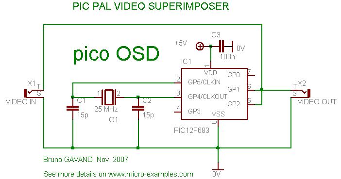

Hi, I have a few questions regarding the OSD project found here:
I have had no luck getting this circuit to work, it displays a very very blurry representation, but the sync is all over the place, I thought about using a LM1881 chip, but it's more fun to try and get it working without.
I dont know if anyone is familiar with this, I have had no response from Bruno, it seems as though he has disappeared!
I have checked the oscillator and it appears to work, I can send video out, and you can just about make it out, but its very "jumpy", i've tried changing the clip level but to no avail, I have seen a project similar in AVR without a sync chip, so i'm guessing it is actually possible.
My video signal is a PAL - I, UK standard Composite input.
I have looked on Rickard's page:
And it states that the horizontal sync is 0v, yet according to the OSD page, it is triggered at 0.625v, is this correct?
There is no information about the Vertical Sync pulse as such on Rickard's page, but on the OSD page it states:
We have to detect a 28 µs low level pulse, there are five of them in the vertical sync and none elsewhere.
Yet it looks as thought it is only looking for one pulse duration in the C code provided on the OSD page.

This doesn't look right at all. The output drive will conflict with the existing signal.

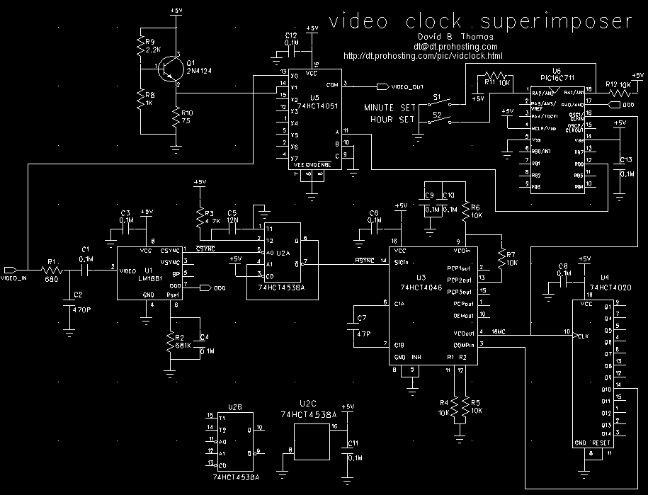

I've seen other superimposers like at **broken link removed**
The schematic is way more complicated, can't say if it's "necessary" or not:
It's ok, it's the same as a number of one-PIC OSD circuits over the years. The PIC output pin is toggled to high-impedance, so it on;y overwrite the video signal when it is writing to the screen.
The problem with the sync jitter is because of the method used for sync detection, the PIC is detecting the sync pulse as a DC voltage threshold, but the video signal is AC coupled through a capacitor and will float a bit depending on video content. You will probably find if you use a blank video signal like bluescreen from your DVD it will probably sync ok.
You can improve the sync detection by using a single transistor as a sync separator, and feed that into the PIC input.

Yes, that is the way I understand it to work, adds 1v or 0v to the signal to represent a black or white pixel and grey values in between.
Interesting about the Sync Jitter, I have only tried it with what I have at home, which is an analog CCTV camera with BNC output and TV with composite input.
I will get a scart - composite conveter and try it on a DVD / VCR output with just the still image displayed.
Would you be so kind as to post a simple diagram of how to use a transistor as a sync seperator in relation to the existing circuit? Will it affect the video because the input and output are joined when using the transistor?
