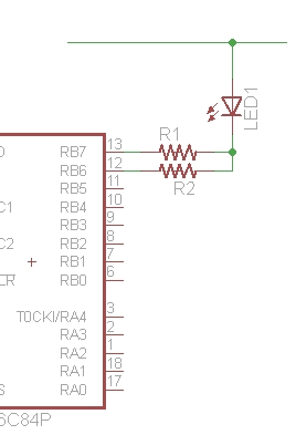

I need to feed a computer on a motorcycle certain voltages to override some programming. I need very little current - less than .5 ma and voltage from 1.8v to 5v. It's going into the ADC on the ECM of the motorcycle.
I also have a similar situation for giving an LED dual brightness in a situation where PWM is not possible.
Will both schematics, shown below, fly? The top one actually uses an LED which should complete the circuit. However; it seems that with the bottom schematic, using R2R, that anything is possible - I could use that for sending the low current voltages I need as well as controlling LED brightness.

The top circuit will not give the result you require.
The bottom circuit is more inline with the requirement.:)

For the LED try this.
Two resistors, one LED, two pins.
Set both pins=0.
Use the tri-state conrole to switch in the resistors.
If both pins are 'input' then no light.
If one pin is 'output' then R1 sets LED current.
If the other pin is 'output' then R2 sets current.
If both pins are 'output' then R1//R2 sets current.

The reason I can't leave both set to OUTPUT and turn 1 on (1) and 1 off (0) would be that the one that is set to 'off' would simply GROUND the voltage coming from the one that was 'on' - correct?
Just looking for a couple set voltages around 4.3 and 4.7 volts for this project. However; I'm also looking for a design that would allow me to use this same design in other projects for dimming leds where PWM is not possible.
