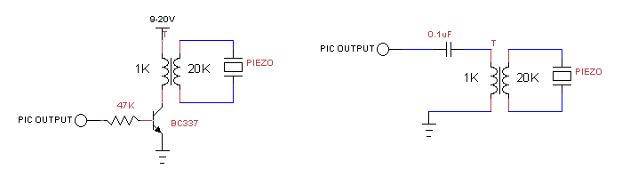

im using pic 16f88 connected to some sensors and a buzzer its like an alarm, my question is can i amplify the output of the pin witch is connected to the buzzer so i can have much louder sound? (the sound driver is the pic so the buzzer is not making any sound if i just connect it to a battey) for example the port output is +5v can i make it +9 and how?

the buzzer is connected to a dip switch and from there i choose between diferent sounds so using a bc547 i have got more loudness but not as many as i want. the code if i use two ports would be very confusing.. i have got one like the foto below witch is as loud as i want and the diferense is because of the transporter... so how i can do this?

Do you have a transformer?
Your piezo sounder disc is driven at 500Hz. It is small and has no enclosure so frequencies below about 3kHz go from the rear around to the front and cancel lower frequencies exactly like a loudspeaker that has no enclosure. The tiny transformer also cuts low frequencies.

From the picture this is a 40mm piezo, it can give output of down to 400Hz. Get one with a plastic resonant box. Get any audio transformer (preferably recycled one from an old audio device) about the same size as the one in the picture. connect the high resistance coil to the buzzer and the low resistance coil via series cap of 0.1 uF to the output of the pic.

It is a common practice to use a transformer, in my burglar alarm a transformer drives the piezo. You need audio transformer with impedance of 1K to 20K , I suggest you get anything similar, it isn't critical.
Like this one, connect the high resistance winding to the piezo.

so one transformer like this will make my buzzer be loud as a syren? and how i can connect it to the circuit?
The circuit on the right will give a gain of 5 and the one with a transistor will give a gain of 10 or more. The 1K winding has a resistance of about 10 ohm.
thank you very very much!! can i ask something last? because this one **broken link removed** might not ship to greece can i use this **broken link removed** ?? and what would be the difference? also the ressistor before the transistor is 47k or 4,7k? thanks a lot again!
The transformer you found looks OK for the job. If you find a cheaper one with resistances +/_ 50% that will be good too.
A resistor of 47K makes the current into the base of the transistor about 100 uA, with hfe of about 100 the collector current is about 10 mA, this will give about the right current for the amplifier.
