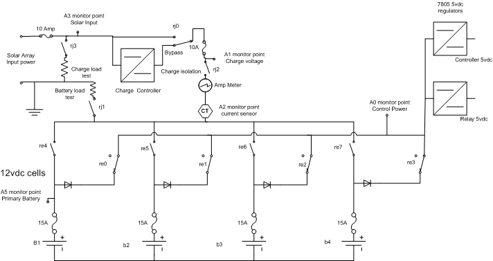

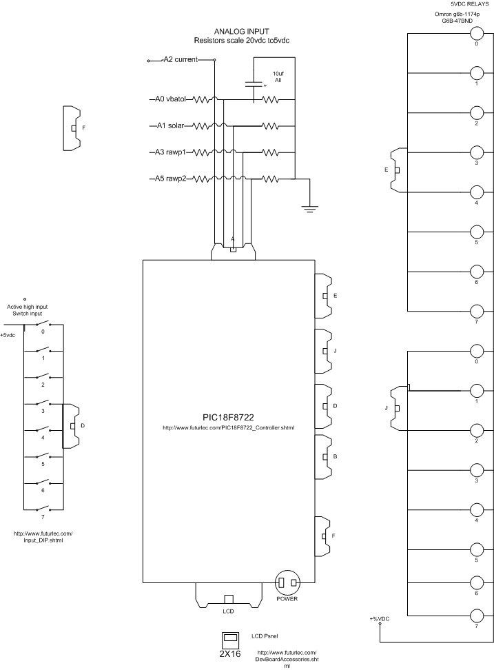

Charging batteries and keeping them healthy is a lot of work. So one of the projects I'm working on is a Solar battery array monitor system using a pic18f8722 controller module from et-base. Here are a few older diagrams (not updated to current system) and some testing (missing some functions) software. This is for my small home system of about 200W of solar input and can store a few kWhrs in the batteries.
The PIC software is C18/MPLAB C.

Here is a data plot of Solar voltage, charging current(tenths of an amp) and C40 led feedback. The spike is a solid LED on the C40 causing my controller to switch to the next battery for charging. Levels of about 100 counts are 1 blink for bulk mode, above 200 is 4 or more blinks for absorption mode charging. The chart show the primary battery voltage but it's charging the backup AGM cells.
