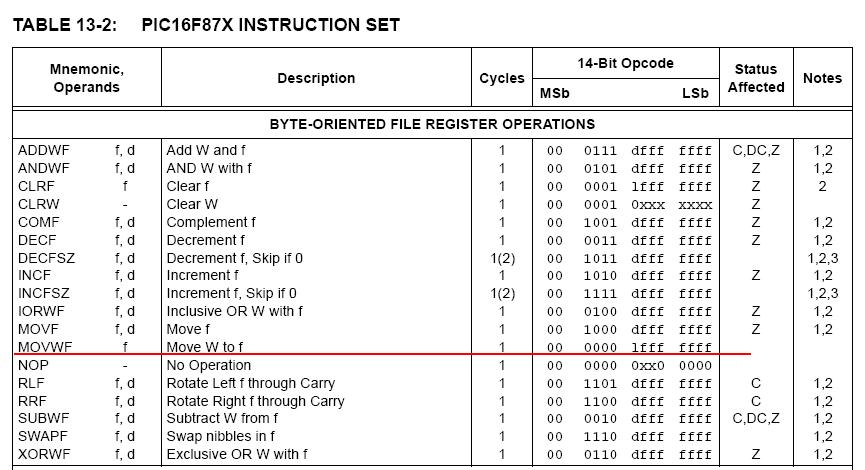

That must be something i don't know about GPRs. If i write:
MOVWF 0x20
i can see that the code is actually
0A0
Why this happens?
Thank you.
The resulting binary code for MOVWF 0x20 is indeed 0x0A0. You can see it in table 13-2 of the PIC16F87X datasheet.
Remember that for direct addressing, only seven bits are used and therefore 128 locations on a given memory bank are directly addressable at a given time.
thnx about your reply motion. can you tell me in which page of the datasheet is that plz because i cannot find it..

Right, thanks to motion I now see what you are doing, you're looking at the machine code produced by the assembler!. This seems rather a strange thing to be doing? - fair enough, I did it, many years ago - but I was writing a PIC disassembler!.
All the PIC instructions are listed in their data sheets, it's hard to miss, it's a complete listing of all 35 instructions.
They are also listed in Appendix B.1 of the MPASM help file, which is installed along with MPLAB - which is usually easier to find than the datasheet.

It's found on page 138 of document 30292c.pdf.
