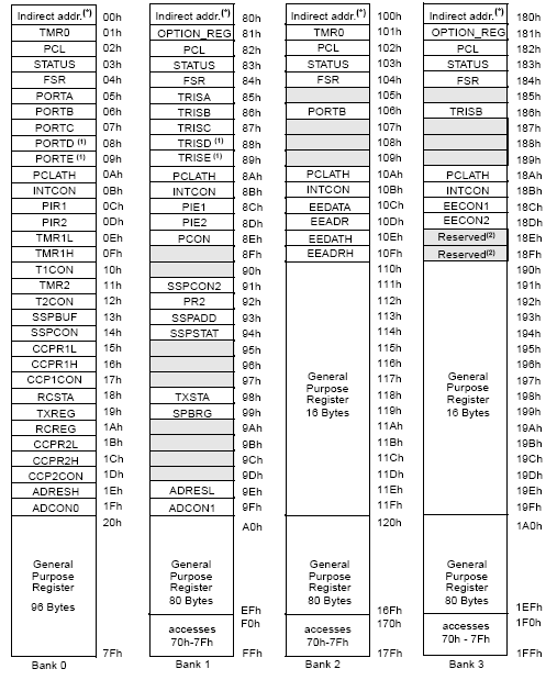

i have a question about pic16f877
the address of it is 000 to 1FF so it must be 512 with three bank
00 -> 128
01 -> 128
10 -> 128
11 -> 128
SO IT MUST BE 512
why it is 386
from Data sheet or any book
If you look at the data sheet you will see that some of the ram space is used by the special function registers and some area are common to all banks.
Look at the memory map in the data sheet and it will make more sense.
did u mean SFRs oR GPRs
if u meant i have to remove the blunk or SFRs from the ram
or count the GPRs i have counted it is 416 not 386
can any one help me to understand this and this ram is for temp Data

The last 16 bytes of each bank are common. This is so you can place variables that are used lots in this area and access them without any bank switching.
