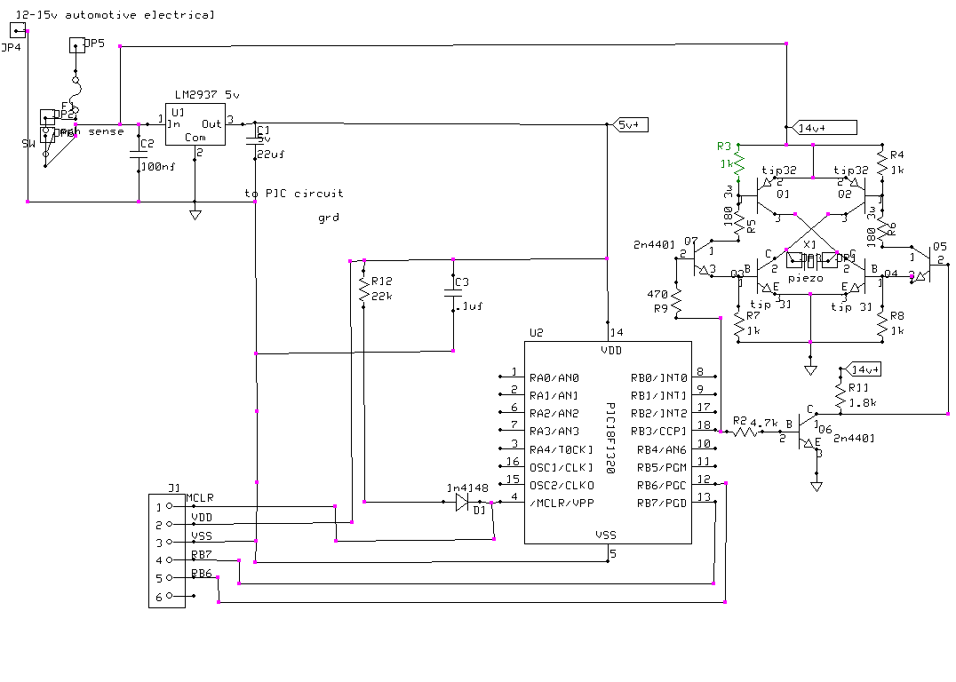

Pic schematic w/amplifyer review
MrDEB
I made all the changes suggested and here is the final schematic.
Plan to etch boards tomorrow but a final review might be good.
any additional design suggestions.
Thanks to Audioguru for the amp design. Hopefully this design won't get hot!

I'd link this thread at the tail end of the last one and make any further comments here. It's at the next stage of commentary now =)
