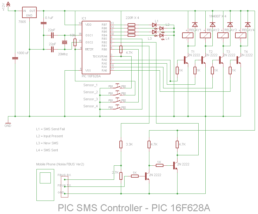

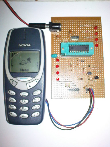

I have hard coded nokias FBUS protocol & hacked many frames sent & receive by nokia by analizing the data frames using a PC terminal.
This is the hardest protocol I have experienced. I Like to show a basic project recently did. It’s a PIC SMS controller.

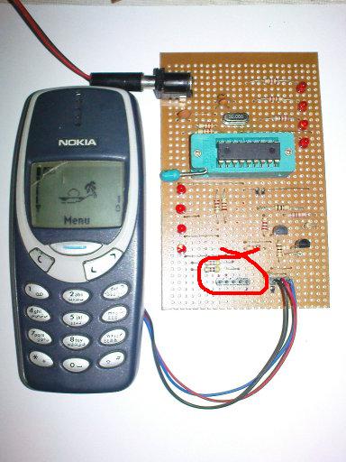

hello guys i'm just wondering what you guys call this terminal that i've encircled? :D
Ummm, a 5pin male 0.1" header ?

I am currently building a similar project to this one. The problem I am having is with the interface from the phone (FBUS) to the PIC. Can you please explain how exactly the interface from the Nokia's FBUS to the Rx and Tx connectors on the PIC works.
Why have you used a pair of transistors on the Tx output from the phone, and why is the input to Rx going via a voltage divider because looking at **broken link removed** project which is doing the same thing, they have just plugged it in directly to the phone, through a 1k resistor.
Also presumably you are using USART in the PIC to communicate with the phone?

moh.alshibli1988: You can buy a nokia FBUS cable to connect the phone. You send data using FBUS commands. Take a look on this site.
Hi sorry for the delay.
Actually we are dealing with 5V (PIC) & 3.3V (Phone) logic. From PIC it transmits 5V & this is too much for the phone. So I added a voltage divider to the circuit. The divider values will deliver 2.75V to the phone.
Phone transmits less than 3.3V voltage that is too low to detect on PICs receiver side so I boost up the signal using two transistors.
Note in my schematic it must swap the PICs RX & TX lines.

Do you reallly need two transistors in a darlington array for the boosting?
Also, do you mean that the PICs Rx goes into the phones Rx or Tx line?
