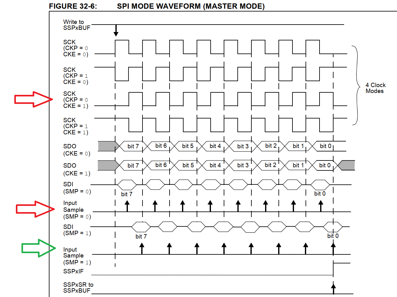

. I see what you mean... however... look at the attached scope plot (pdf file attached). The yellow is CS, the blue is SCLK and the pink is SDI (displaying a byte of 10100100). I have put the pink vertical cursor on the rising edge of one of the clock pulses and you can see this is when the incoming data is at its most stable, so I would have thought this is where I need my PIC to sample the data.
From the datasheet extract, I have CKP = 0, CKE = 1 so am on the line indicated by the first red arrow:
I would have thought I need my sampling to be SMP = 0 (the second red arrow) on the rising edge of the SCLK. This does not work. Setting SMP = 1 seems to work, but I dont know why.
That was the point I was making.
With the settings above (and SMP = 0), the data changes on the falling edge of SCLK. Without slew rate limiting I see it changes on both the rising and falling edges.
Thanks for your help and keep the comments comin'

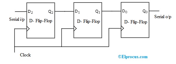

With a lot of synchronous logic, the same edge that is used to clock data is used to capture the level.
Think of a typical synchronous shift register as an example:
The clock rising edge both captures the data and changes it; that gives the longest possible time for the new data to propagate through the preceding device output before the next capture, so allows highest speed and best stability.
