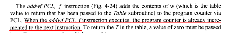

Am I correct to say that a zero in W would result in an infinite loop in the table lookup code:
Table
	addwf PCL,F
	retlw	'a'
	retlw	'b'
If W is "0", then it will not change PCL, the next instruction is then executed and the literal 'a' is return in W. Or will the next instruction be the Addwf itself?
If W is "1", then PCL is modified to point to the retlw 'a' instruction so again it will return the lateral 'a' in W.

Thanks for the explanation. The explanation fits nicely.
I didn't expect PC to be incremented after the Addwf PCL instruction as the operation is known as the computed GOTO with PCL changed. PC is definitely NOT incremented after the normal goto or call instruction after undergone a similar PCL changes.
I have found the answer to the question.
Apparantly the PC has already been incremented when the addwf instruction is being executed. So there is no need for a post increment after the instruction finished.
