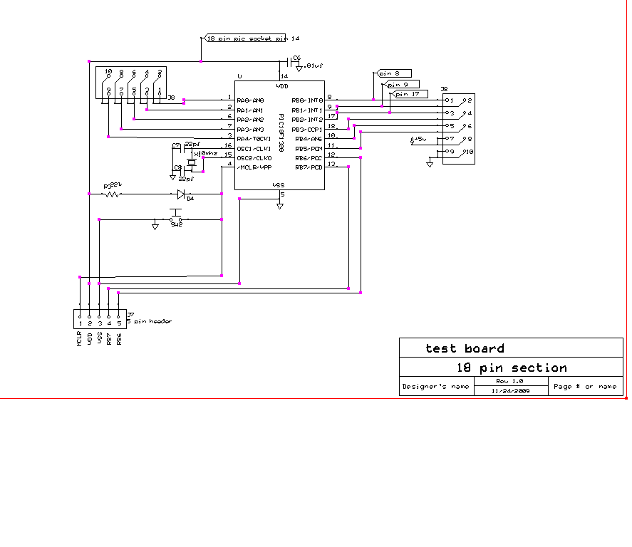

Here is the PIC test board or protype test board.
Has a spdt selector switch to select either the 40 pin or 18 pin socket with indicator LEDs
lots of daughter board connections and LCD headers (don't have to rewire everytime I want to run an LCD program (need to redo code for the 18F1320)
Got the idea from **broken link removed**
the board streamlines the rewiring of parts for a breadboard. Also frees up breadboard space.
Dear nice effort. But where is the schematic you used and backside picture of the board for the board readers to evaluate your efforts
Will post updated pics of schematic.
backside is not real pretty as it is all point to point hard wiring using wire wrap wire.
test board to date
here is a schematic of what I have so far. Thinking about etching a board to eliminate alot of "wire traffic" which adds to the confussion.

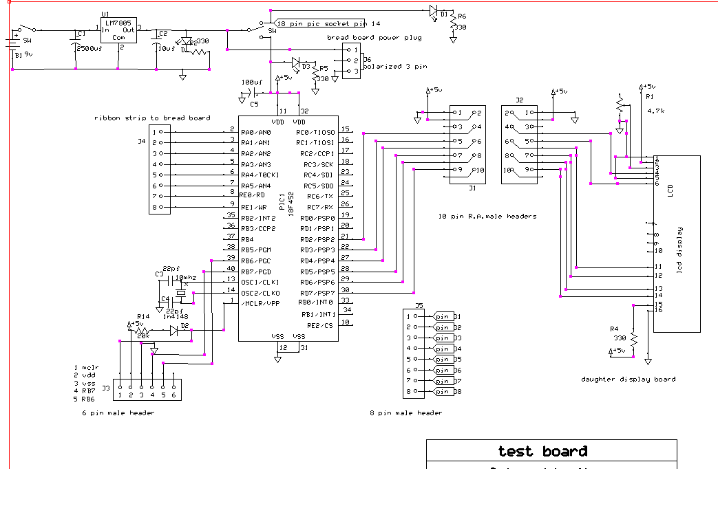

Looking at that schematic, you seem to have an LED (D1) that tells you when it's off!
D1 and D3 are both connected to the selector switch. When selected the LED comes on.

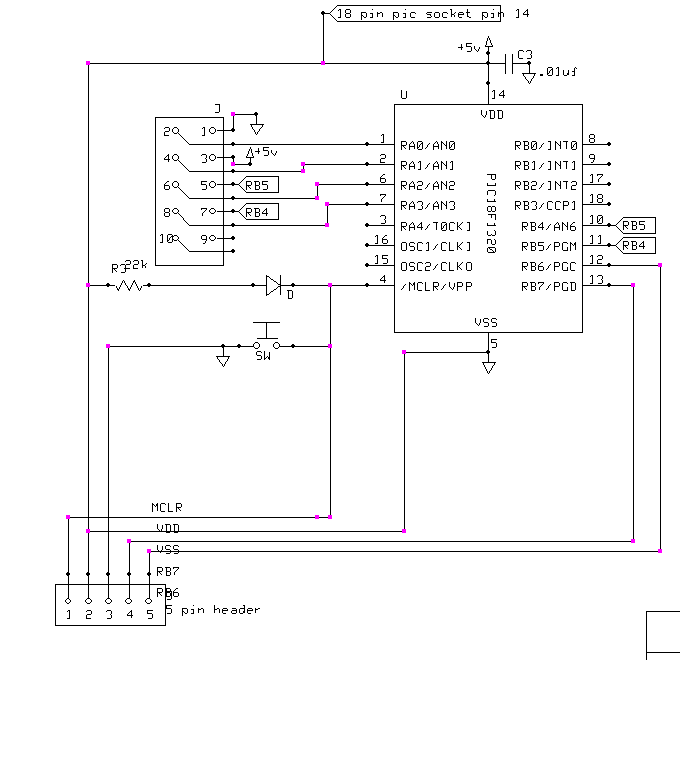

I have an updated schematic and then on to a pc board.

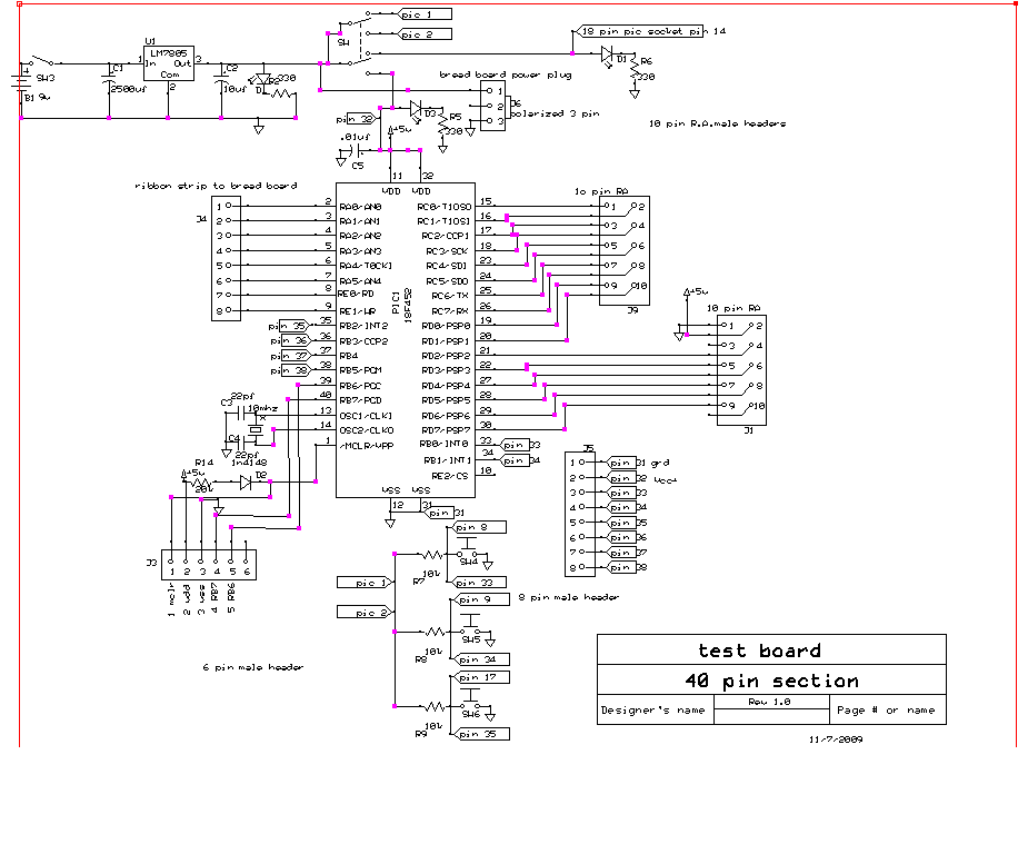

updated test board schematics
added an LCD port to the 40 pin section, several logic buttons.
I have express pcb files if anyone interested.
This board should save lots of bread board repetitive circuits.
ANY addition suggestions welcome
