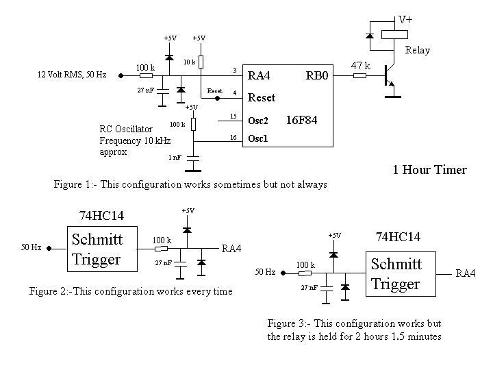

I wrote a programme for a 16F84 PIC to operate a relay for 1 hour as in Figure 1. But the results depend upon what signal is input to RA4.
If a sinewave of 50Hz is input, as in Figure 1, it works sometimes but not always.
If a slope limited squarewave signal is input, as in Figure 2, it works everytime.
If a pure squarewave signal is input, as in Figure 3, it works but the delay is 2 hours 1.5 minutes - obviously slightly more than half the pulses input to RA4 are missed.
Does anyone know why?
According to the PIC data sheet, RA4 has a Schmitt Trigger input, so the input wave shape should not be relevant - provided it is large enough in amplitude to cross the upper and lower thresholds.

I suspect noise on your 5V line maybe the problem. Your AC will drive your 5V line higher than 5V and may mess up your other RC oscillator - especially if your circuit has a low standby current. Try putting a 5V zener across your capacitor instead of the diode to 5V.

Thanks for the comment Mike, but I would have thought that the current through the 100 k resistor into the diode would be small enough to not cause a problem. Besides, I would like to know why this is happening.

Your fig 2, shows a schmitt trigger whose output goes from 0v to some positive value and this one works. The other figs have a 0v level determined by the catching diode. I don't know why you have the 27n capacitor in circuit?, it has a reactance of ~120K at 50Hz and time constant of ~2ms (Fully charged in 5CR = 10ms, suspicious ) :eek: . Short answer is I don't know but I'm going to look into it when I get a mo.

Ed, the reason for the 100k and 27 nF is to act as a low pass filter to hopefully remove the spikes from the AC mains that Phill mentioned.
I'm keen to hear your conclusions.
The 3 dB point is given by F = 1/(2Pi RC) = about 60 Hz.

The whole idea of this is to get reliable SQUARE pulses entering the PIC, by adding such a low frequency low-pass filter you will be making the drive nearer a sinewave than a square wave.
So dump the capacitor!, also dump the two diodes, they aren't required, the PIC already has them internally - see figure 5.4 of the 16F628 datasheet.

I've built your fig 1, minus the PIC (New computer, PIC stuff not installed yet) and haven't really found any reason why it shouldn't work - the only thing I can think of is that maybe the diode to +5v is high resistance this would mean that the max input voltage to RA4 (8.5v) could be exceeded, however as Nigel correctly says diodes are already built into RA4 to Vdd and Vss and this would mean that that upper PIC diode was faulty too! (cyclic latchup?, clutching at straws here, if that is a problem then new diode and PIC would solve it).
T'other thing is I've tried it with both silicon and schottky diodes, not that it should matter much, and it looks like you may be exceeding the abs max ratings for RA4 (>-0.3V wrt Vss).
On the 'scope the waveform looks OK, ie a phase shifted slowish slope waveform and with the 0.1v hysteresis buit in to RA4 that shouldn't be a prob.

Thanks for response. But if you look at my Figure 3, it is being presented with a squarewave but will not work. The only config that does work reliably is Figure 2 - a non square wave. ?? I know the PIC has internal diodes, but I was once told by an IC researcher (admittedly a few decades ago) that the internal diodes are sometimes not adequate.
The PIC data sheet for the 16F84 states that RA4 has an internal Schmitt Trigger, so it sould work on slow waveforms - as we found. My main question is - why is it having a problem with the square wave as per fig 3?
The RC filter is to attenuate any spikes from the mains.

Obviously the input to the PIC is different in fig 3, or it wouldn't have any effect, have you tried scoping the RA4 pin to see what the waveform is like?. For that matter have you tried a plain 100K feeding the pin, and nothing else?.
Hi Len,
Can you do a test by increasing the clock speed of the PIC to 100KHz or higher and see if the problem remains?
