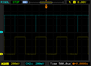

So next I moved to the 12F1840, altering the TONE define to RA0, and the TRIS statement accordingly - but while it compiles fine, all you get out is a few clicks. With the scope on RA0 it appears to be getting the timing from TMR0, but not the frequency pules from TMR1?. I've tried various of the RA pins, and none of them work.
