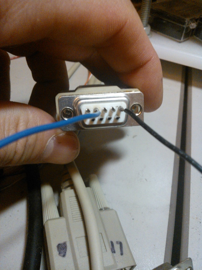

.........What pin is data and ground?
Using PBP, PortB.1 is the 'Data' pin I am using on an 18F1320. Gnd is pin 5 of the DB-9.
Using a TTL to RS-232 adapter, then a null modem, then the PowerLinc.

Pinout? I was asking because the manual I downloaded shows the serial port having Serial in (TTL) and serial in (RS232). Same for serial out (TTL and RS232) I just wanted to check which you are using. Probably your device is different.
You can test your RS232 by plugging into you PC and us a terminal program to look at what the PIC is sending.
That is how I was able to see when I got the right serial protocol, by comparing what they sent and what I was sending.
