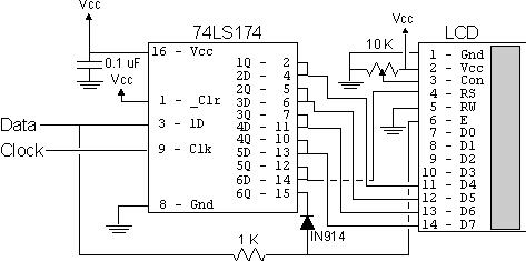

Here's something that may interest you.......but pdf's not allowed....
Send me your email addy and I'll post it on.... :cry: :cry: :cry:
2 wire lcd interface
try this site .... only mistake on page is the 74ls174 should be 74ls164 or a 4094....... www.rentron.com/Myke1.htm also try www.talkingelectronics.com very good info here have helped me for many years from when i was 15 and im 35+ now
