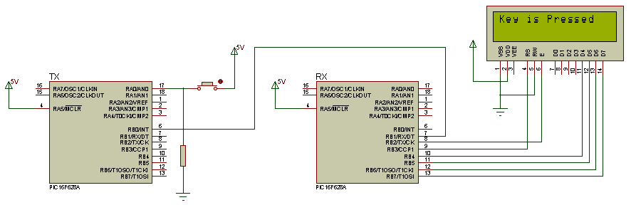

For most small applications, there is no need for encoding the data. It's a fiar bit of overkill, and there are many radio modules that simply run with UART data as they encoded/decode it on the fly
I take it your using Proton still? In that case, have a look at this code'
TX;
[FONT="Courier New"]Device = 16F628A
Symbol Key = PORTA.0                 ' Define which Pin the Button is on
' Start of program;
ALL_DIGITAL = True                   ' Make all I/O's digital
Input Key                            ' Make the Key pin an input
While 1 = 1                          ' Create an infinate loop
    RSOut "Header", Dec Key, "Z"     ' Send the current status of the key
    DelayMS 100                      ' Delay for 100mS
Wend                                 ' Loop for ever[/FONT]
RX
Dim Key As Bit                              ' Define a register for the Key data
' Start of program...
ALL_DIGITAL = TRUE                          ' Make all I/O's digital
Low PORTB.1                                 ' Set up the IDLE state of the RSIn_Pin
    RSIn Wait("Header"), Key                ' Wait for the text "Header", then grab the key data
    If Key = 1 Then                         ' Check if the key was pressed or not
        Print At 1, 1, "Key is Pressed"     ' If it was then display this text
    Else
        Print At 1, 1, "Released      "     ' Else if it wasn't then display this text
    EndIf
uart-and-button-example-png.13113
Click here to watch this program and circuit simulated
