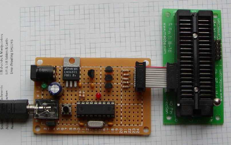

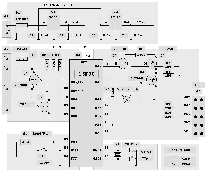

Homebrew programmers are a great learning exercise but you can spend an incredible amount of time developing the software (and the firmware, if you decide to design a programmer with a PIC).
If you're interested, here's my third design which uses a 16F88. The first and second versions were almost identical but used an 18F258 and an 18F2320, respectively. All three use ICSP control circuitry similar to the melabs serial and usb programmers.
More recently I thought I might try building a novelty programmer using an 8-pin 12F683 with most of the intelligence built into the PC host software but it's hard to find the time, and also, I suppose it's really time to start designing for the USB interface.
Have fun. Regards, Mike

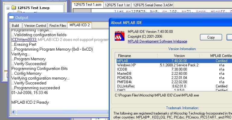

William At MyBlueRoom said:
It's a good ICD2 clone, but DONT use a 16F877A or 16F876A (use the non A parts) the 661.HEX won't work for MPLAB 7.40
Sorry Bill, you're wrong. The '876A and '877A devices work fine with MPLAB v7.40. Perhaps there's a problem with your bootloader file.
Attached, please find the modified bootloader file for '876A and '877A devices. Rename it from .txt to .hex after downloading it.
Regards, Mike
Regards, Mike
I'll try it tonight, Where did you get it?
I got it from edaboard. I recall there were a couple different files offered up. One worked and one didn't. This is the one that works.
