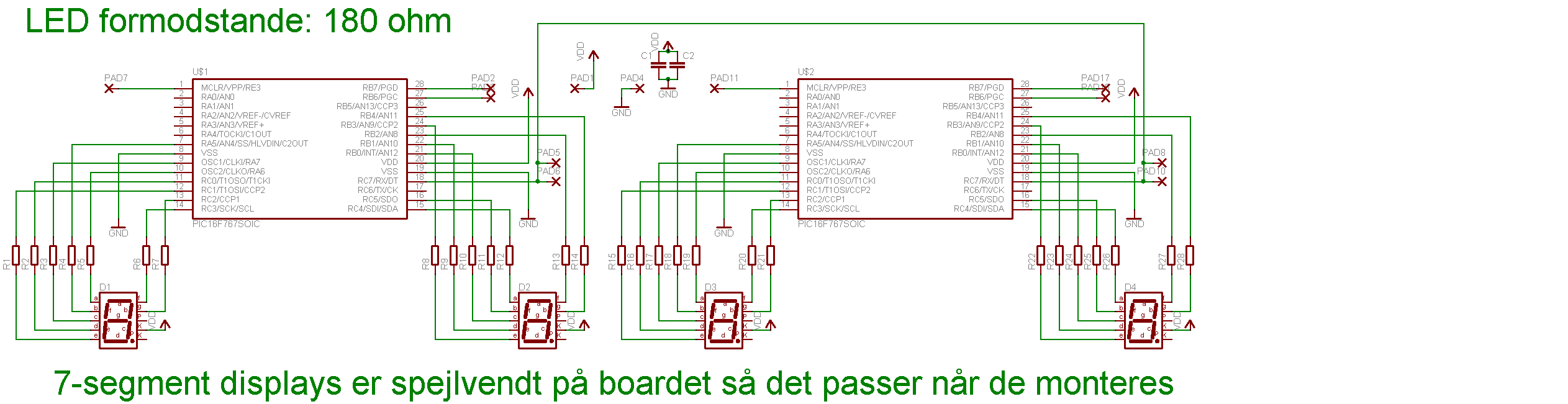

Hi forum,
I have two PIC16F767 driving some LED 7-segment displays directly from the outputs.
I then have a PIC18F2320 sending digits to the two PIC16F767 using the hardware USART at 19200 bps.
I'm having these strange problems - sometimes the PIC16F767 outputs won't change and just stays high and now I have a problem where the serial line can drive each PIC seperately but not together at the same time. The TX pin of the PIC18 is directly connected to both PIC16 RX pins - only a 100k pull-up is connected besides the PICs. The PIC16s are on one board and the PIC18 is on another - they are connected by 7" (17cm) wire.
Is there something in basic serial communication board layout I'm missing here? Some series resistors somewhere perhaps?
Thanks.
Best regards,
Futterama

hi Futterama,
Please post your full code and if possible a circuit diagram, it makes it so much easier for us to help you.
Files attached as zip and image attached exported from Eagle.
The PIC18 just sends 2 bytes to the PIC16s representing the RPM value.
I had this setup working fine, then came the missing segments problem and now I have this serial problem.

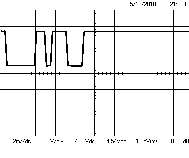

Hi again,
I put a scope on the serial line. Here's the results:
One RX pin connected:

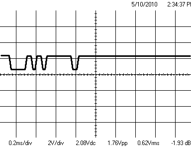

Two RX pins connected:
When only a single PIC16 RX pin is connected to the PIC18 TX pin, the signal looks fine. When I connect the second PIC16 RX pin, it seems to be pulling the voltage up. Actually when only one PIC16 RX pin is connected, it also seems to be pulling the voltage up but this does not affect the signal - it must be within the PIC digital input specifications.
So what could be pulling the voltage up on pin RC7 on PIC16F767?

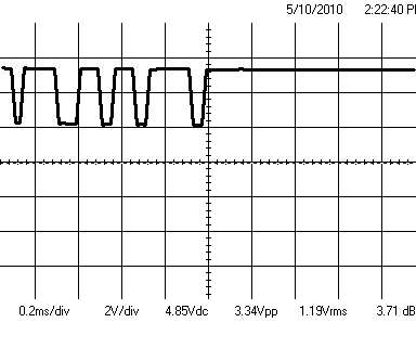

Just for trying something, I removed the 100k pull-up at the PIC18, and now look what happened with both RX pins connected:
Could I have damaged the PIC18 TX output while fiddling with the boards?

For the uart on the 16F767 to work correctly both TX and RX have to be input. This is not true for the 18F2320, the TX pin has to be output. Do you set it to output?
Well, I have not set it for the PIC18 since I use the built-in rs232 directive, but perhaps this does not set the TX pin as output. I will give it a try.
Actually, you are right about the PIC16F767, both TX and RX pins needs to be set as inputs - I have the TX as output, perhaps this does something to the UART. Will try to fix this also.
Nope, it didn't help to set the PIC18 TX pin as output - I guess the built-in rs232 directive (CCS compiler) sets it as output.
It didn't help to set both TX and RX as inputs on the PIC16s.
But thanks for the suggestions anyway :)
Oh I think I just found the error. I'm setting the default output in the beginning of my program using:
// Set startup pin states
output_a(0xFF);
output_b(0xFF);
output_c(0xFF);
The compiler will set all affected pins to output before outputting the value (0xFF) and this makes the RX pin an output. DOH! My bad :-(
