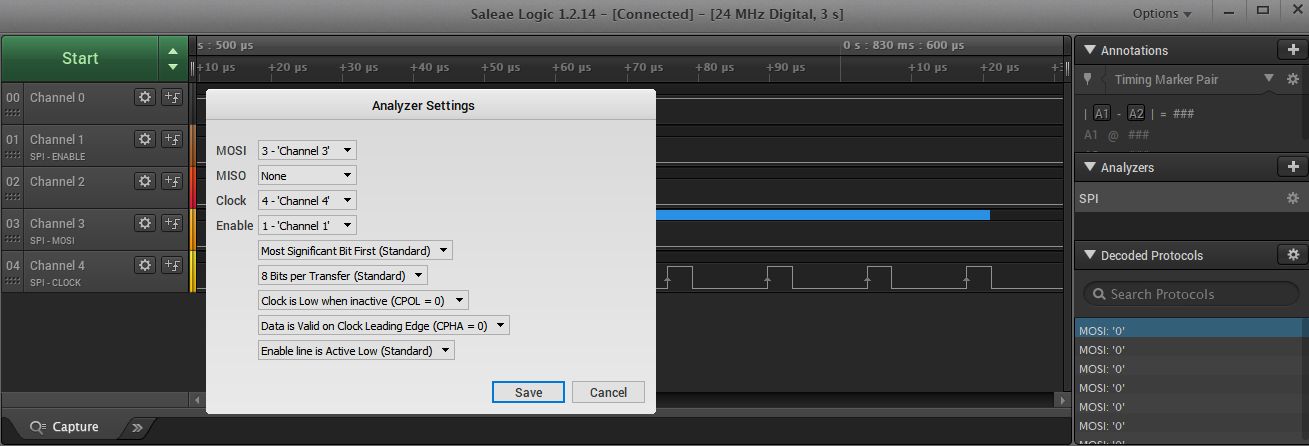

Here's a program with settings as the #64 video. Also a Data analyser reading, showing everything that was recorded.
I also checked the MISO on an oscilloscope, and even though I can't record it easily, I could see a weak reading approx 1/2V, probably what shows on the Analyser.
There were some comments on the other SPI thread, (A program with READ in it) but it was established that there is no MOSI, so does this attached program follow the suggestions.
If the Oshonsoft SPI doesn't work in this way, 'Bit banging' has been suggested also. Is this a good idea?
EDIT:Above I wrote MISO, it should read MOSI.

The 5110 SPI is Write Only.
The PIC is the Master and the 5110 is the Slave.
Master Out Slave In = MOSI
Master In Slave Out = MISO
So at PIC the MOSI pin has the Data input to the 5110
NOTE: some 5110 do not come with all the resistors fitted.
4 * 10k and 2 * 1k
https://www.amazon.co.uk/LCD-Module...r=8-1&keywords=nokia+5110+lcd#customerReviews
https://www.microchip.com/forums/m148739.aspx
E

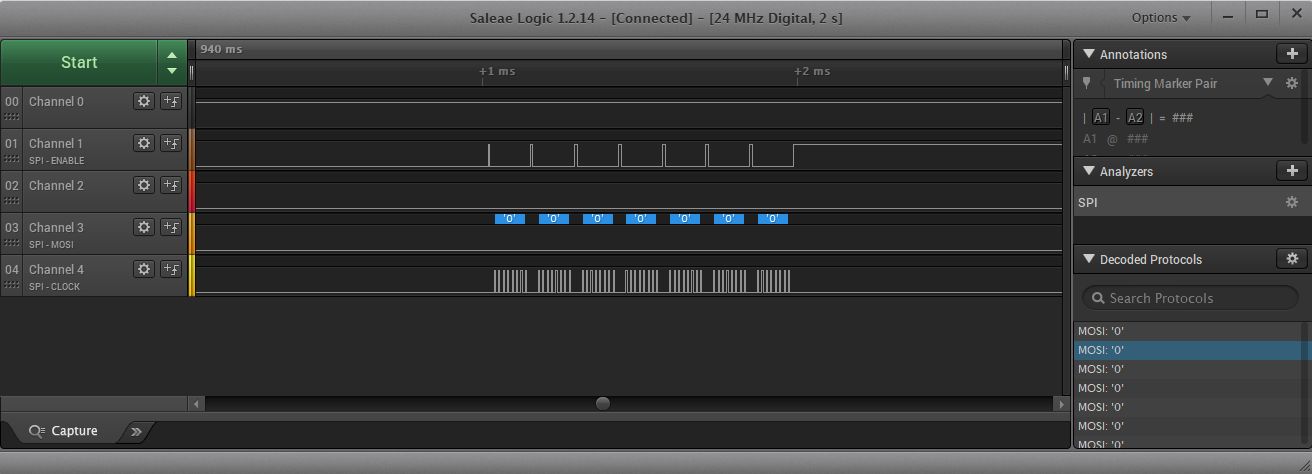

Attached shows the digital protocol. Is the MOSI pulled up or down? The analyser appears to show '0' at MOSI. Is it the 2x1K resistors for this? (and which other 1)
EDIT: Just tried the MOSI PIN (at the 5110 input) to check the connection, with a slow ON/OFF it shows ok on the oscilloscope.
C.

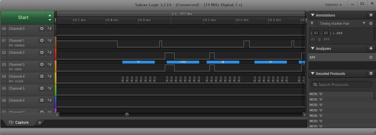

I tried a previous program with the longer version of SPI (I substituted the SPI settings) , here's an analyser read out showing MOSI working. ????
C.
EDIT: Channel 2 is connected to the C/D PIN on the module. As it shows the same movement as the MOSI PIN it may be some sort of echo?

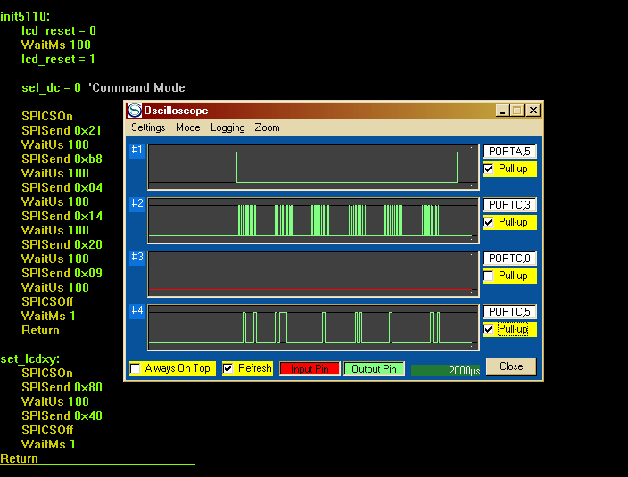

Program the 18LF2520 with this simple program.
Connect the 5110 to the PIC pins as per the program [ no changes made ] but note that Oshonsoft SDO means MOSI .
The LCD should display all pixels.
The image shows that the correct data is being sent from the PIC when simulated.
E
