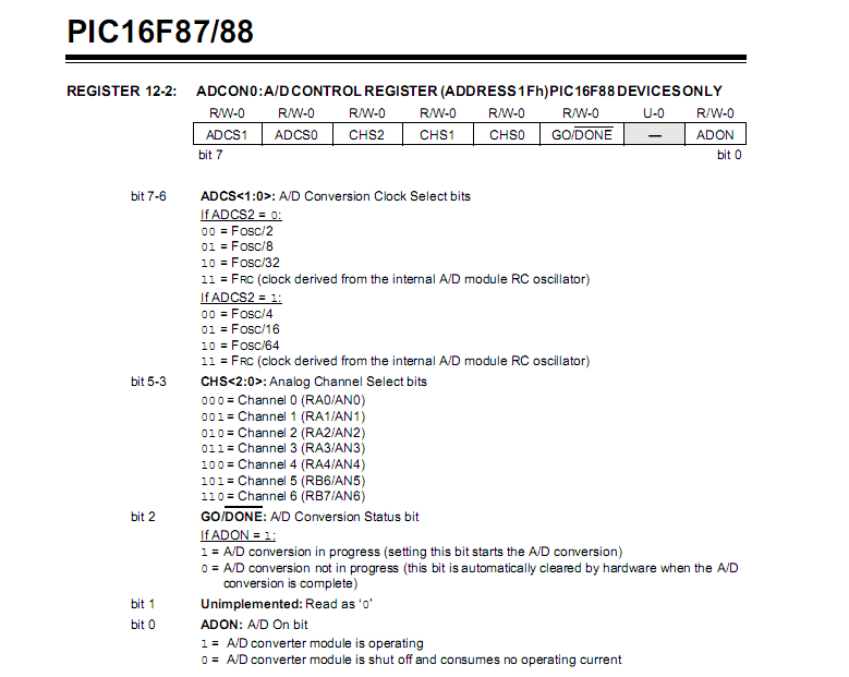

Hi, I have recently started with PICs, I have been using the 16F628, but it hasn't got ADCs, I need at least 6 ADCs, preferably 10-bit, but 8-bit will do, in a low pin count chip, 18 PDIP would be perfect, Also must have serial COM for it shall send the ADC values to another chip.
The 16F88 has analog
