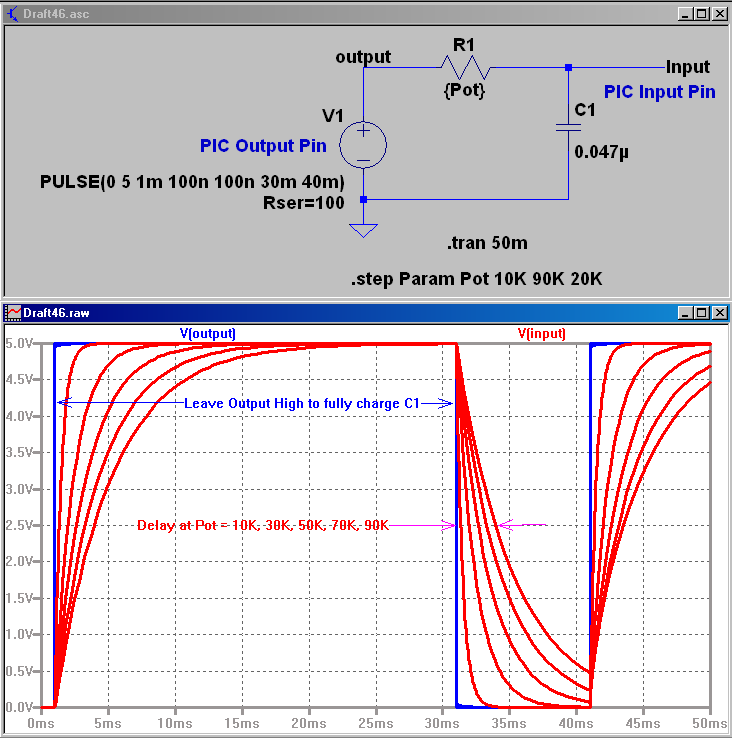

Make a series R, shunt C timing network, where the series R is a pot. Drive one end of the pot via a port pin with a square-wave generated in PIC code. Hook the junction between the R and the C to a different PIC port pin configured as an input. Use code or a Timer to measure how long after you switch the output pin the input pin goes from 0 to 1 or vice versa. The time delay is proportional to the pot resistance...

The learning curve on using a Timer inside the PIC is shorter than learning how to use the A/D. Here is the basic idea. The PIC input switches from 1 to 0 as the voltage swings through ~2.5V (Vcc=5V).
Your code causes the Output pin to switch from 1 to 0 and you simultaneously clear the Timer register. You set the Timer to count the CPU clock until the input goes from 1 to 0. The value in the Timer register is proportional to the Pot resistance.
You dont even need the timer/counter just count in software how long it takes to go to a 1. Using the timer /counter might overflow too easily as it is only 8 bits.
Timer 1 is 16 bits. The path from the CPU clock to Timer1 can be prescaled by 1,2,4, or 8.
The 16bit value in Timer1 can be latched into CCPR1H:CCPR2H on a down-edge on the RC2/CCP1 pin.
Or you can do it all in software...
