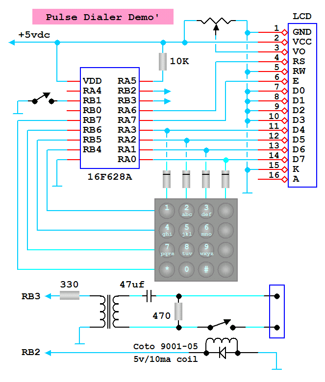

hi friends,,
I have finished building this project and it s working well.
But now i want to extend it so it can take about 5 to 10 phone numbers and dial it when the alarm goes off.
I want it to be programmable by any user with help of a keypad or a telephone in the parallel line without the help of A computer where it programs it again and again.
Pls help friends,,,
Thanks...
Store the numbers in the data EEPROM area, and write all the program parts you need to do the keyboard reading, display, storage and retrieval.
A 16F628 may start to struggle for pins a bit, moving to the slightly larger 16F876 may be an idea.
I suspect you could do it with an 18 pin PIC with one or two pins left over if you use 4-bit LCD interface mode and re-purpose the LCD D4-D7 driver pins as column or row driver lines for the 4x4 switch matrix.
If you do need more pins you might look into the recent 20 pin offerings like the 16F690 which has become quite popular.
