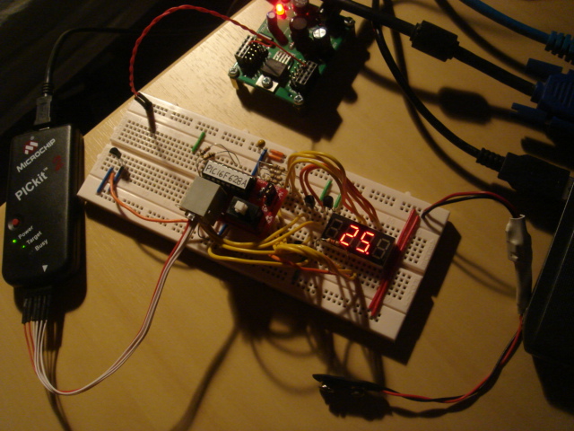

I had my wisdon teeth out friday and saw it as a great oportunity to get stuck into making a Thermometer on my week off.
I am 99% there. I have a somewhat 'simple' but MASSIVELY confusing issue and I cannot rectify it.
Please help.
My situation:
I read the datasheet for the DS18B20 direct to digital Temperature Sensor over & over & over & over & over while waiting for the part to arrive.
Getting my head around Dallas's "1-Wire" communication was a challenge, but I grasped it and start coding.
The part arrived, Built the circuit, smoothed out some bugs and its working. To an extent.
I have tested the timing and communication with the Temp Sensor and am reading data from it sucesfully.
I am using 12-bit resolution as I want to have the display display to 1 decimal place. i.e, 25.4
12-bit resolution gives increments of 0.0625 degrees C. Which i can round to the neartest .1 of a degree.
MY DILEMA comes when trying to display the number on a 3 digit 7 Segment display which I am multiplexing.
I am Calling 3 Tables, 1 for each of the digits of the display.
I have tried everything I can think of and want to ask someone to check it out.
The assembly code is heavily commented to show what I am trying to do.
The display only display the 2 LS digits, then if i physically swap position of the DIGIT_ONES and DIGIT_TENS routines the display does something else.
(The code is too long to paste here so I have placed it here, click to view. PIC16F628A - DS18B20 Digital Thermometer)

I would suggest you multiplex the displays using a timer interrupt, which makes the process totally transparent.
If you check my tutorials, there are two that do this - the double 7 segment one, and the 8x8 LED matrix.
There's also no need for multiple tables, the same table can decode each digit.

Hi Jake,
You're starting out with a sign extended two's complement 12-bit number formatted like this;
S = sign bit
I = integer (7-bits, 0..127)
F = fraction (4-bits, X16, .0625 increments)
SSSSSIII IIIIFFFF
I think Nigel is suggesting that you use simple math to convert the temperature into decimal "tens", "ones", and "tenths", something like this perhaps;

Just from reading that, I'd take a wild stab: your tables are crossing 256byte boundaries. You can either align your tables, or calculate the full PC (instead of just PCL):

I agree. Once you have simple math that produces 0..9 values for your "hundreds", "tens", "ones", and "tenths" variables, all you need is a single table (array) for the 7-segment data patterns;

Yes, keep it simple - you only need a table to map the 7 segment bits to your connections.

So can you/anyone explain, in words (not code, i will do it once i have a way) how to use simple math to acheive the coversion for the 'fraction' nibble.(4xLSB of 12-bit number)
So, the hex number in the table below is the lower nibble of the TempLo register, the equivelent temp in the next column. how can i use simple math to convert the hex number to the corresponding number to display, so i can use that to call a table with the 7 segement arrangement in it?
DECIMAL  HEXADECIMAL  TEMPERATURE-EQUIV  NUMBER-TO-DISPLAY
   0        0000           0                  0
   1        0001           0.0625             0.1
   2        0010           0.1250             0.1
   3        0011           0.1875             0.2
   4        0100           0.2500             0.3
   5        0101           0.3125             0.3
   6        0110           0.3750             0.4
   7        0111           0.4375             0.4
   8        1000           0.5000             0.5
   9        1001           0.5625             0.6
  10        1010           0.6250             0.6
  11        1011           0.6875             0.7
  12        1100           0.7500             0.8
  13        1101           0.8125             0.8
  14        1110           0.8750             0.9
  15        1111           0.9375             0.9

hi Jake,
Ref the program you posted.
When your program CALLs DIGIT_TENS, the ADDWF PCL,F sends it straight to CALL REARRANGE_RESULT, it does this 6 times then the STACK over flows.
I have just stepped through Pommie's fraction routine with pen and paper putting a 111 in templo, and i got 4 as the answer and i must say, how on earth did he come up with that!

While you were working on that, i was trying to put together a BIN to DEC routine and just finished it. colin55 gave me the idea (thanks col) of decrementing the binary number and counting how many times it goes past 10, then saving the left overs in the ones wreg.
i wanted this project to have some of my own code in it at least haha.
here it is below, and with pommie's permission i will steal his fraction routine, and with your permission use your interrupt routine and 12-bit shuffle routine that was about 3.5 times as short as my attempt.
I think I have everything to put it all together. Big cut and paste job now lol... I will post my result be it good or disarterous :D
... i didnt finish commentint it, its 3 am, im going to bed lol. but it works. see attatchment
