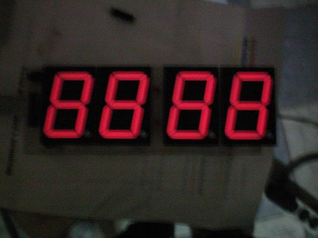

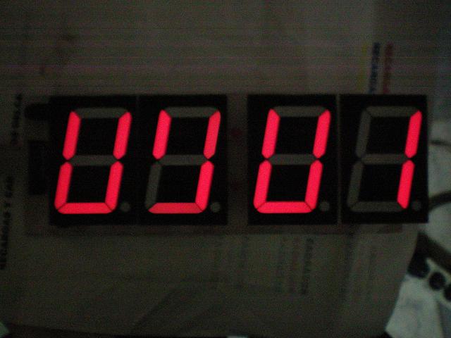

Hello everybody:
I'm having a this problem (see attached pics) using pic16f628's timer 1, when applied to a seven segments display.
As you can see in the second pic , the segments A and G don't show up. In the first pic I'm using a different program . Here's the current program :

What could be the problem?

Try changing all the call led7 instructions to movlw 0xfe and see what happens.
Mike
That is bits 6 and 7 of Port B which happens to be where the timer1 crystal would be connected to. And, I see you have enabled timer 1 oscillator.
Try changing it to,
		movlw	b'0011[COLOR="Red"]0[/COLOR]100'	;disables timer b0, internal clock b1, enable oscillator b3
		movwf	T1CON		;prescale 1:8 b5-b4
Hey, it worked :D
I tested the program using Oshon PIC simulator, so I trusted on this too much
Thank you a lot Pommie :)
