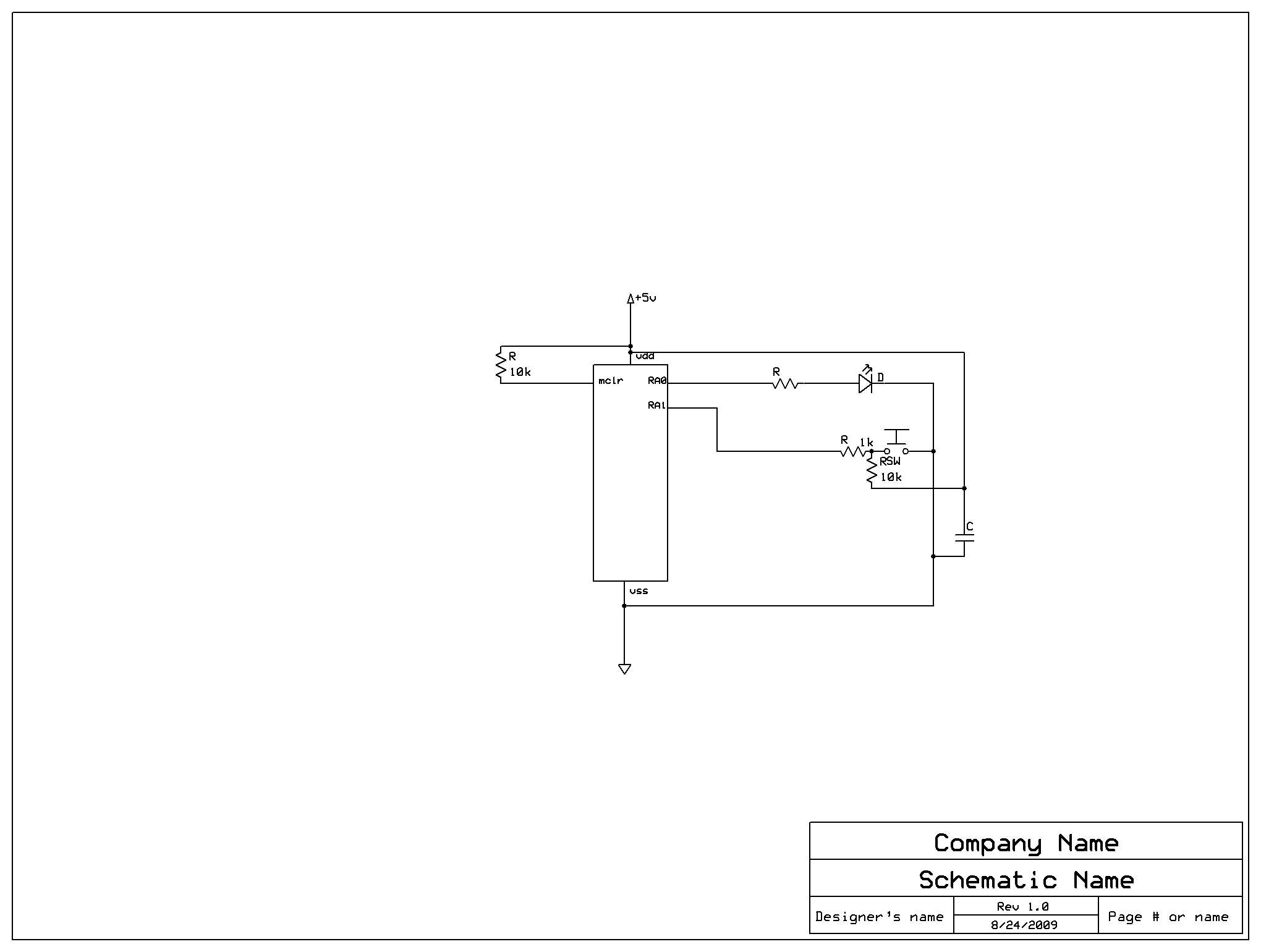

I want an LED connected to pin RAO to glow if pin RA1==0
when i run my code the LED keeps pulsing on and off regardless of what value RA1 equals to.
could someone plz help me. Thanks

He is toggling the whole porta and hasn't set porta up right
What C are you using ?
im a "she" hehe. im using hi-tech c pic lite in mplab. Im a beginner. Plz assist me.

By using RA0 instead of PORTA you're just setting the one bit for your LED.
Also, what do you have connected to RA1? If it's a switch or button, you should use a pull-up resistor, or the built-in weak pullup on RA1, which you can enable by adding to your init() function:
  WPUA1 = 1;
  RABPU = 0;
This code works if you set the hardware up right.

Here how i set it up
To me this looks better

sorry didnt respond quicker, i was learning for a test which i wrote 2day. RA1 has an infrared receiver module(TSOP48) connected to it. The output is active low. I never connect a switch there. I tried your code Kpatz but the LED is still pulsing continuously. thanks Be80be and Kpatz for taking time to try and help me.
Hey fantabulous68 I thought you have connected an IR module on your input.Of course it will toggle when it receives IR pulses :)
If you are checking from a switch don't forget to put a pull up resister on the input pin like 4.7K.
My design is an infrared liquid level detector. Im in the beginning stages of my design. I want to get the led indicator working for now. The hardware for my proximity detection circuit is working. When an object is detected the receiver IC outputs a low which is fed INTO pin RA1. i want an LED connected to RA0 to glow when detection occurs. All the LCD functions work.
Im having some problems with my code. I suspect the problem lies in my init function and main program. tink my initialisation of portA is wrong and maybe the order in which i call ledindicator function.
1) The LEDindicator function doesnt work when i join it as a entire program with the LCD funtion. It only works separately. I need it to work together
Please assist me in getting the code working. Thanx
yeah thanks Gayan Soyza, i realised that when the microcontroller function generates 40KHz, the LED blinks on and off real fast HOWEVER, with the NEW code that im using below. The LED is permanently ON at all times. i only want the led to glow when an object is detected. eg if detect object then LED glows, if dont detect then led doesnt glow. i dont want the led permanently on.. What should i do? im generating a 40khz pulse at RA2 and that is an output from the microcontroller. The receiver module is connected to RA1. when it detects an object it outpus a low which is fed into the microcontroller. The LED is connected to RA0.

i got it to do what i wanted. It just had to swap the order of the two functions in my main program. YAY :). Im a happy girl now
