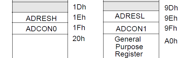

ADCON0 EQU H'1F'
ADCON1 EQU H'9F'
ADRES EQU H'1E'
CARRY EQU H'00'
TRISA EQU H'85'
TRISB EQU H'86'
TRISC EQU H'87'
OPTION_R EQU H'81'
OSCCON EQU H'8F'

Your code doesn't appear to have a config instruction.
Edit, also, in the chip you're using the ADC registers are in unusual locations,
Edit2, they're in the same place as the 16F88 so code for that chip may work.
