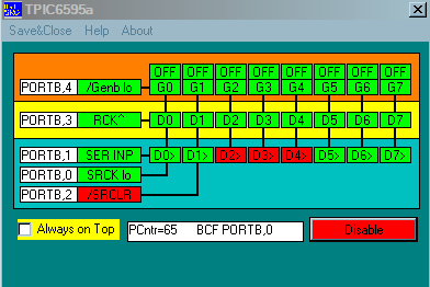

Ran in your program in the OS sim,OK, using a modified external S/R module. Note this ext module clocks on the low to high edge.
Look at these two images.
The S/R shows the 0x38 LCD setup code byte, have you wired the LCD so that D7 of the S/R is the LSB [D0] of the LCD.???

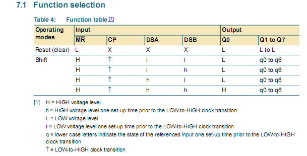

Also the clocking pulse in the program is going high to low,, the LS164 datasheet states a low to high clock pulse edge.???
Also are you resetting the LS164 at power up.??

Checked thru all the LCD init and data transfer, it checks OK in simulation.
