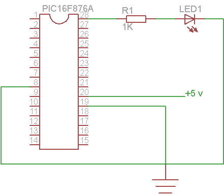

Hi all,
I am very new to microcontroller. I try to write my first program using PIC16F876A to trigger led 3 second interval. Code is
#include <pic.h>
#include "delay.h"
#include "delay.c"
main()
TRISB = 0x00;
PORTB = 0x00;
while (1)
PORTB=0x80;
DelayS(3);
PORTB=0x00;
DelayS(3);
And i compiled the code using Hi-TECH lite version
picc --chip=16F876A port.c
I programmed PIC16F876A using icprog(using JMD programmer option). Finally i connected power supply and LED(see the attached file), but nothing happen. Please help me.

Assuming you have the crystal caps and power correct.
You have the LED on RB7 which is used by the ICD interface. To make like easy move the LED and resistor to RB0 and alternate RB0 between 0x00 and 0xFF.
If it blinks on RB0 check the other 7 pins. If it works on all by RB6 and RB7 you have compiled the code in debug mode which does not allow the use of RB6 and RB7 as IO.
HTH
Hi santhosh :)
is the header file (delay.h) is the one that come with hi tech pic c
if so there is no such a term called dealyS() (unless u modify)
if your use that header file
DelayUs(x) Delay specified number of microseconds
DelayMs(x) Delay specified number of milliseconds
are only available functions with that header
and where is your configuration word ?:rolleyes:
__CONFIG( PWRTDIS & LVPDIS & WDTDIS &XT & UNPROTECT);
and there is no need to add "#delay.c " directive
and u have to copy delay.h to the working folder
the pre-processor directive and config word should like this
# include<pic.h>
# include"delay.h"
#define XTAL FREQ 4MHZ
and one thing u have to specify your crystal frequency
above it is 4MHz
read the header file carefully you may find the solution

Don't forget to connected MCLR [pin1] to +VDD
You mean to connect MCLR (pin1) to +5V right...
I could`t get 12pF capacitors and 20MHz crystal here. I got 10pF capacitors and 6MHz crystal only :(. I successfully connected all components as mentioned page, and changed the code to assign PORTB=0xFF (thanks 3v0). But still microcontroller not running what i expected, RB0 to RB7 was always ON(I was thinking crystal looks like old, the shop person cheated me:(). I will try to get 12pF capacitors and 20MHz crystal and update status to here. Thanks to all...

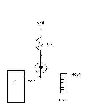

I've also modified my Board 2 to add an ICSP socket, I posted the layout here somewhere a while back. I added a diode and resistor to MCLR, no jumpers needed.

Like this would work
