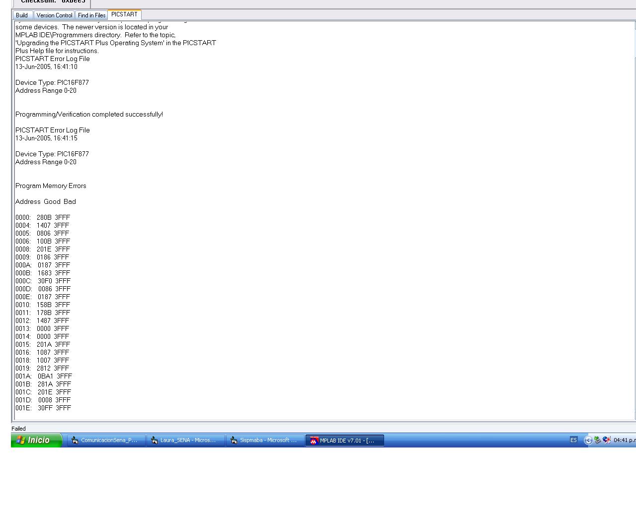

Another problem just ocurrs, i bought a PIC16F877 just this morning and the first time i programm it. In the screen appears something about errors in directions. Some kind of list with ADDRESS GOOD BAD...Have you ever see anything like that?

Can post us a screenshot?
Maybe it has to do with correct possitioning of code in program memory of the PIC (ie exclude interrupt part of memory from normal part)

Let me take a screenshot of the error

there it goes.....this ocurrs during the verify proccess
im using MPLAB v.7.01, it also occurs in V.7.10
and PICSTART plus as a programmer
