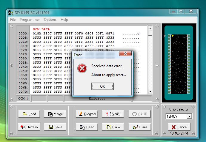

As it begins to put the program into the PIC it says the board recieved a data transfer error and is applying a reset. It does the same thing with the test program if I try to reload it.
Reading the ROM that was transferred, it follows the code that was suposed to go into it for about half of the first row and then just displays 3FFF in every other spot.
Now, I am able to program other PIC's in this programmer such as the PIC16F627 and the PIC16F628 flawlessly, but when it is set to program the PIC17F877 with its specific hexfile it just gives me that error.

heck, I just tried putting the blank code template file microchip gives you, successfully built it through MLAB, and it still won't load it without bringing up that same error message. (-_-)
the only other programmer that I have is an old k8048 velleman kit which was outdated once I replaced my windows 98 to a vista laptop (no rs232 ports)
(heh, of all the times something else could have gone wrong with the program it had to be now. )
has anyone ever recieved this error?

Thank's guys for your help, but I'm beginning to believe that both of these PIC's are somehow mysteriously broken in the same way (when you read back the rom that was transferred before it redieves the error, sometimes it stops at the first row,sometimes a few rows down)

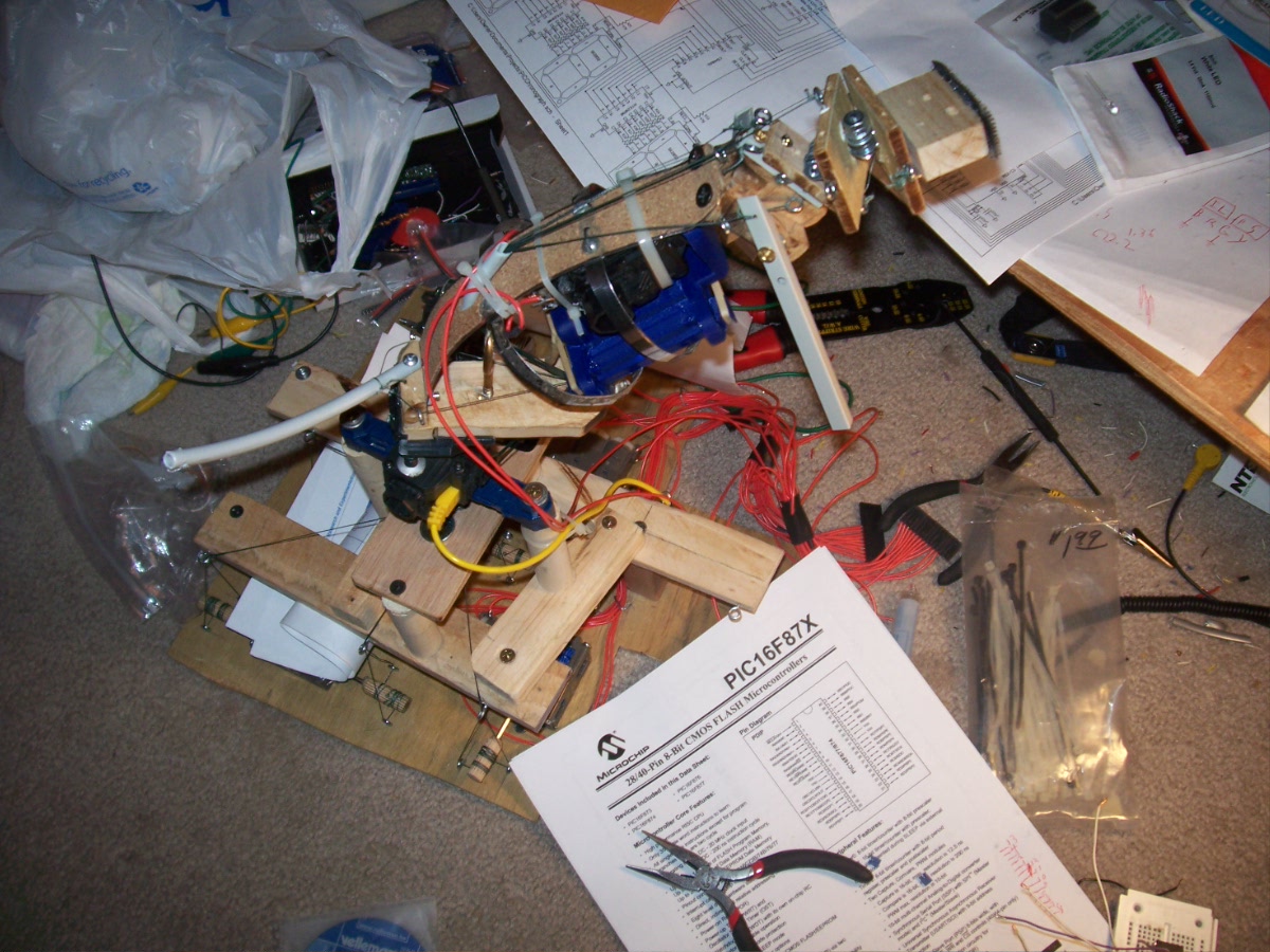

Anyways, here's the fox without the skin on it as it sits now...unprogrammed and disconnected from the board.

Well, I did eventually end up finding the problem... it was the programmer.
That day before before I looked everywhere within the state until I finally found a store that sold USB based PIC Programmers. I do have to admit, it was definately an upgrade (this new one by Olimex can run directly from MLAB), but it was a little expensive (try ~$90) ohwell. It fixed the problem.
What still boggles my mind is how this old USB programmer wasn't able to program the PIC16F877 just like it did before, but would sucessfully program both the PIC16F627 and PIC16F628.
It does use a PIC16F628 on the board itself. Waybe it is what was causing the problem. I'll try looking for some firmware and replace that PIC.
